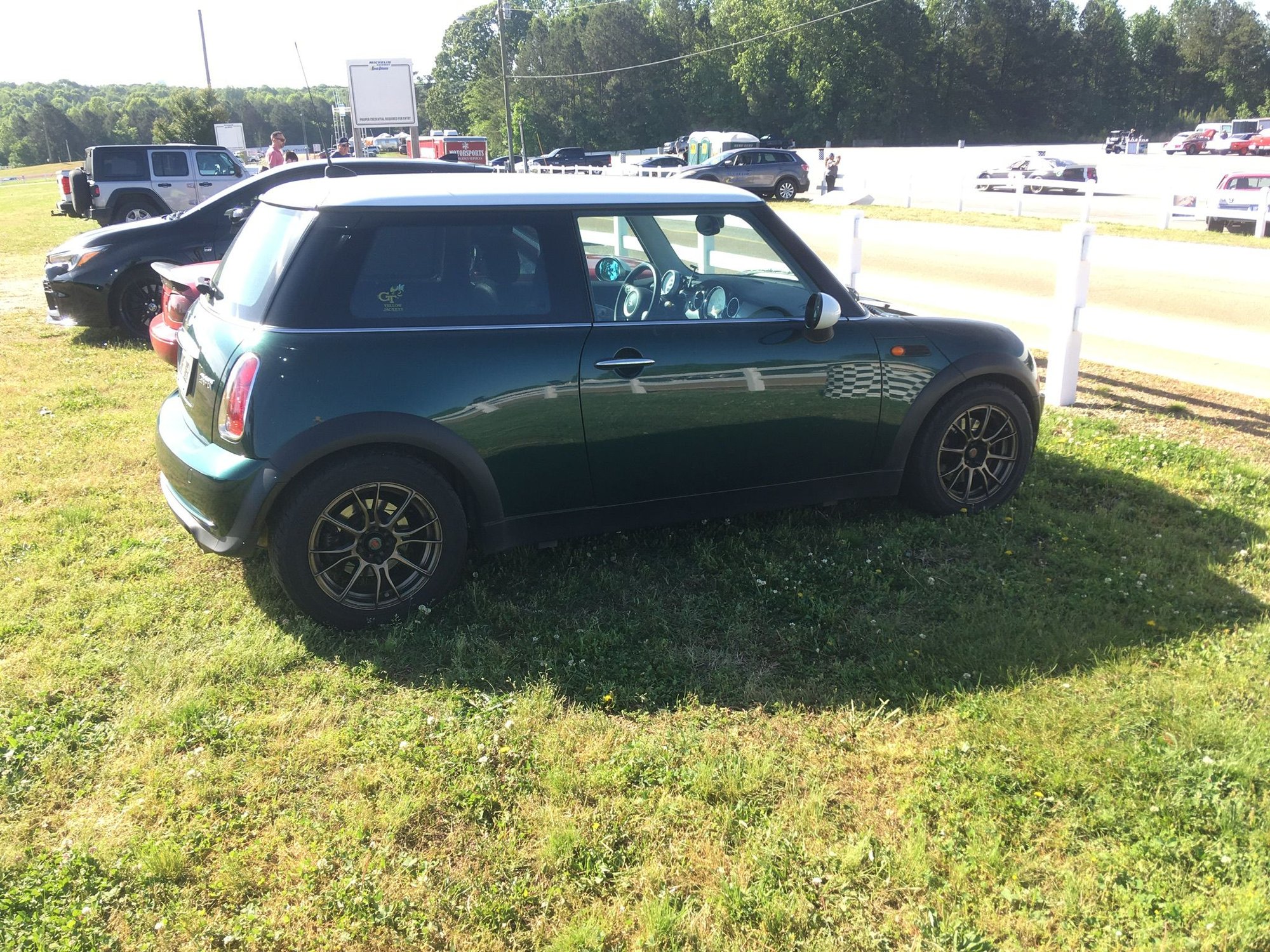

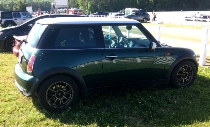

I haven’t really driven my R50 much lately since I’ve been busy with family business and haven’t been riding, but my dad and I went to The Mitty today, which gave me the extra push that I needed to swap the summer wheels and tires back onto the car, wash it, and fix my rear fog yesterday.
Poorly composed photo from the Road Atlanta infield for proof :
I didn’t take a real camera this year and didn’t take that many photos - I’ve seen a lot of these cars before - but I did happen to snap a shot of a Chuck Beck 904 driven by Randy Beck. There were plenty of arguably more interesting and/or rarer cars there, but I’ve always liked the 904/6.
Mediocre iPhone cameras do a pretty good job of hiding flaws (and mediocre detailing jobs).
And finally, proof that I did actually fix my rear fog light. I end up spending a lot of time without it (a fact that I’m not wild about) since my bike rack occupies the same spot. My hitch receiver was supposed to clear a rear fog, but it doesn’t. A few years back I cut the connector/bulb socket in half and pigtailed it, but it broke at the bulb end last year. We’ll see how long this repair lasts - hopefully I’ll have better luck this time. It looked like it had fatigued the pins I soldered to from constant bending - not surprising given they were never designed for this purpose and had little mechanical support. I would post it, but it’s quite ugly.
Now I need to drop the exhaust and replace the center section hangers to see if it fixes a rubbing issue I’m having. I stupidly didn’t change them when I changed the exhaust. I might have already done it, but getting the van running has been priority. I finally fixed the reverse lights, and we built new battery cables for it. But, I haven’t finished replacing the bulkhead connector or re-looming the engine bay wiring.
Oh, and an unexpected bonus from the trip was scoring a Leonard Wood autograph. I didn’t realize he was going to be there.

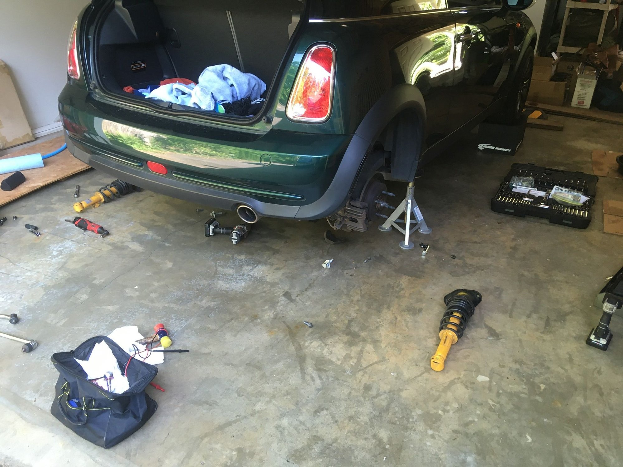

I finally got around to doing a little more work on the R50. I softened up the rear dampers a bit and replaced my exhaust center section hangers.
Hopefully now my cat won’t hit my underbody brace. It doesn’t solve occasionally clipping something with it though. Oops.
I have a few more goodies to install sometime. If I had been smart I wouldn’t have filled my tank last week so that I could change the fuel filter this weekend.

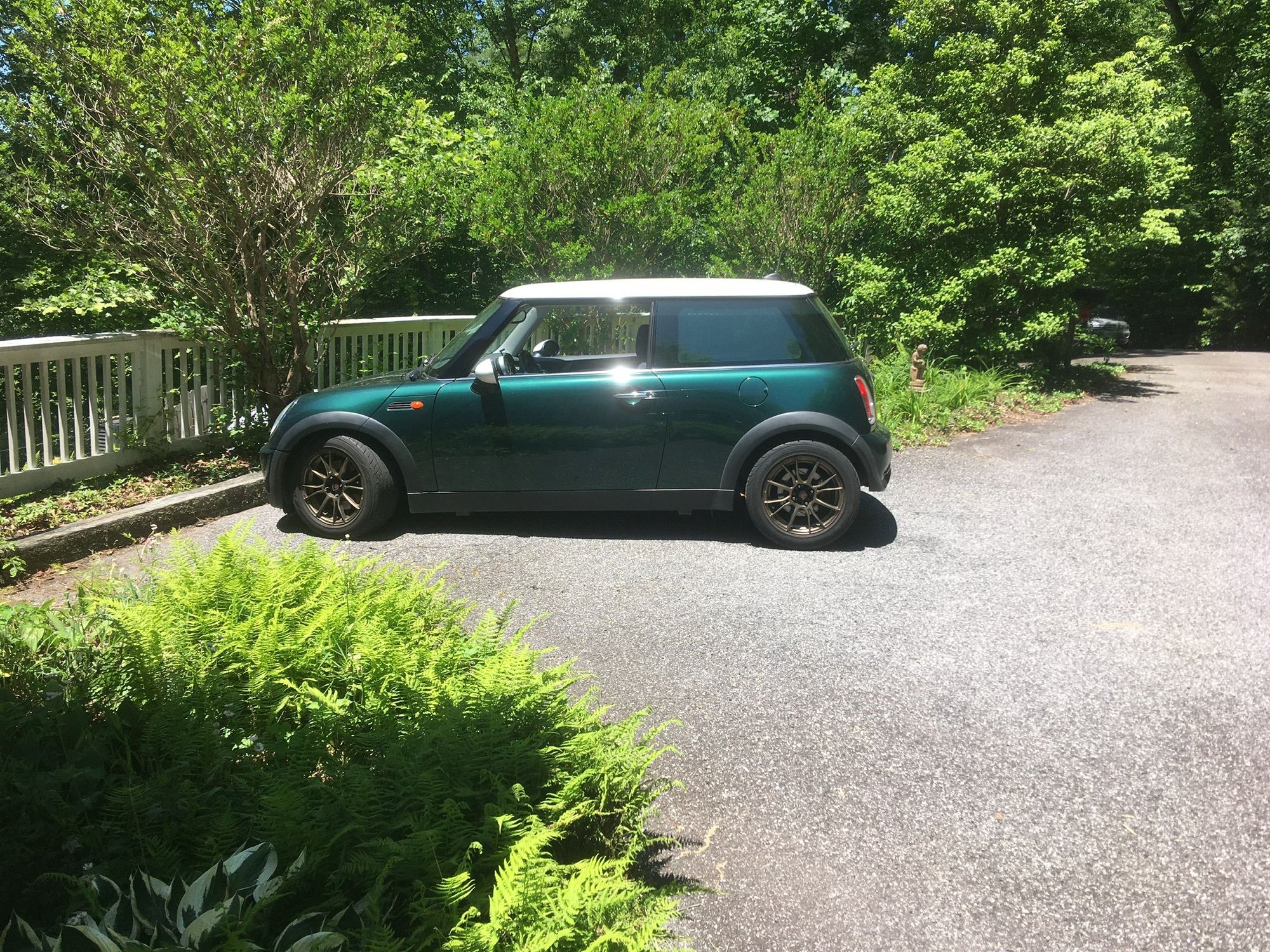

I finally reinstalled my euro parcel shelf. I hate dealing with the installation but like having it. I kept telling myself I would do the wiring for my driving lights but got tired of not having a finished look. I also velcroed the controller for my multi-gauge to the back of the shelf and did a little vacuuming.

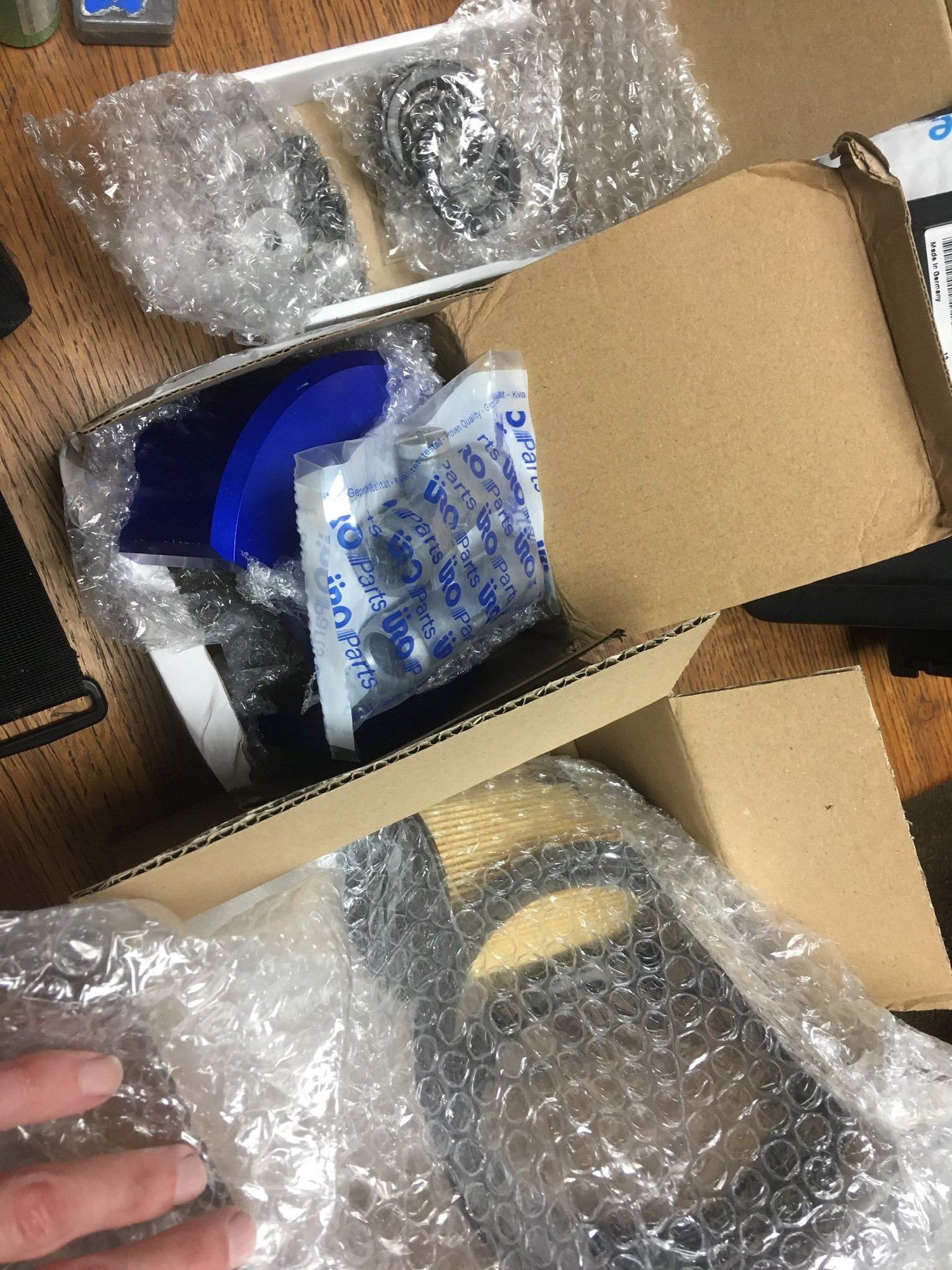

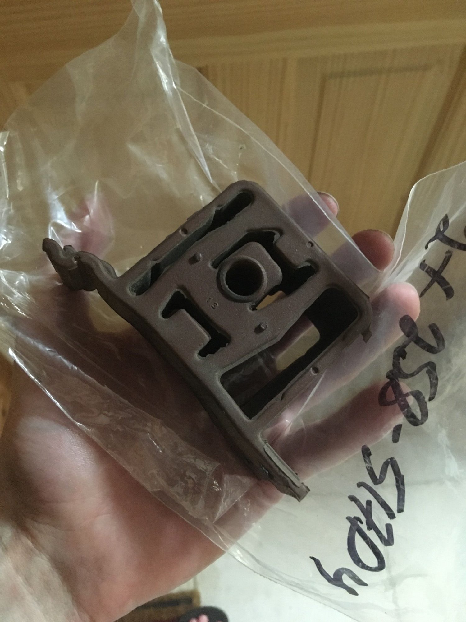

I’m currently behind on maintenance since I’ve been busy with a new job and not particularly close to my tools and workspace. However, I did finally deal with one issue (well, kind of two, actually).
At some point in the past few months a rough idle surfaced, but there were no codes. I’ve had poly inserts in the trans mount, full poly bushings in the lower motor mount, and a Vibra-Technics upper mount in the car for quite a while with no issues.
At first I thought it was just the lower mount going for some strange reason. It certainly felt like a broken lower mount. Wonky clutch takeup, bounced my cat off the x-brace a few times, weird behavior on hills. I got stuck on a big hill on Northside Drive in stop-and-go (mostly stopped) traffic in maybe 100 degree heat, and I would have sworn the lower mount was hosed based on the trouble I was having with it.
I pulled the lower mount… and the bushings looked fine. Swapped in a stock rubber one, and the car drove better - I think - but the rough idle was still there. I finally got the tank down low enough to dump in a bottle of Techron, and the rough and hunting idle disappeared within only a few miles. I seem to recall a recent thread where someone else experienced the same thing. My car has sat for extended periods recently, so I’m not surprised. If I can time fuel levels right, I’ll change the filter soon-ish.
The only explanation I can come up with for the motor mount is that the combination of unusually high, extended ambient temps, a mount attached to the oil pan, and idling in city traffic softened the poly bushings up more that the stock rubber. I have a new Vibra-Technics lower mount to swap in when I find the time - probably at the next oil change.
