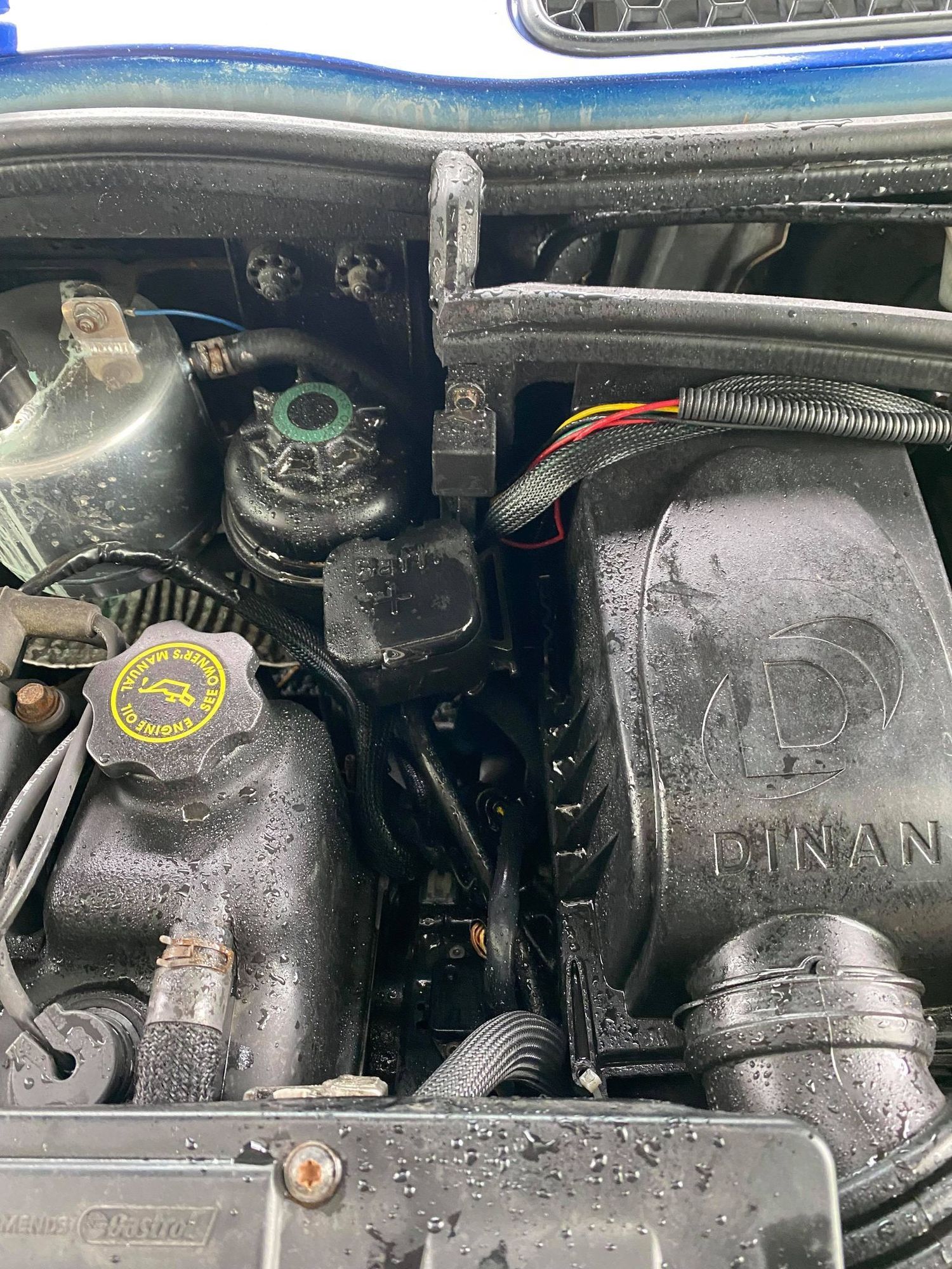

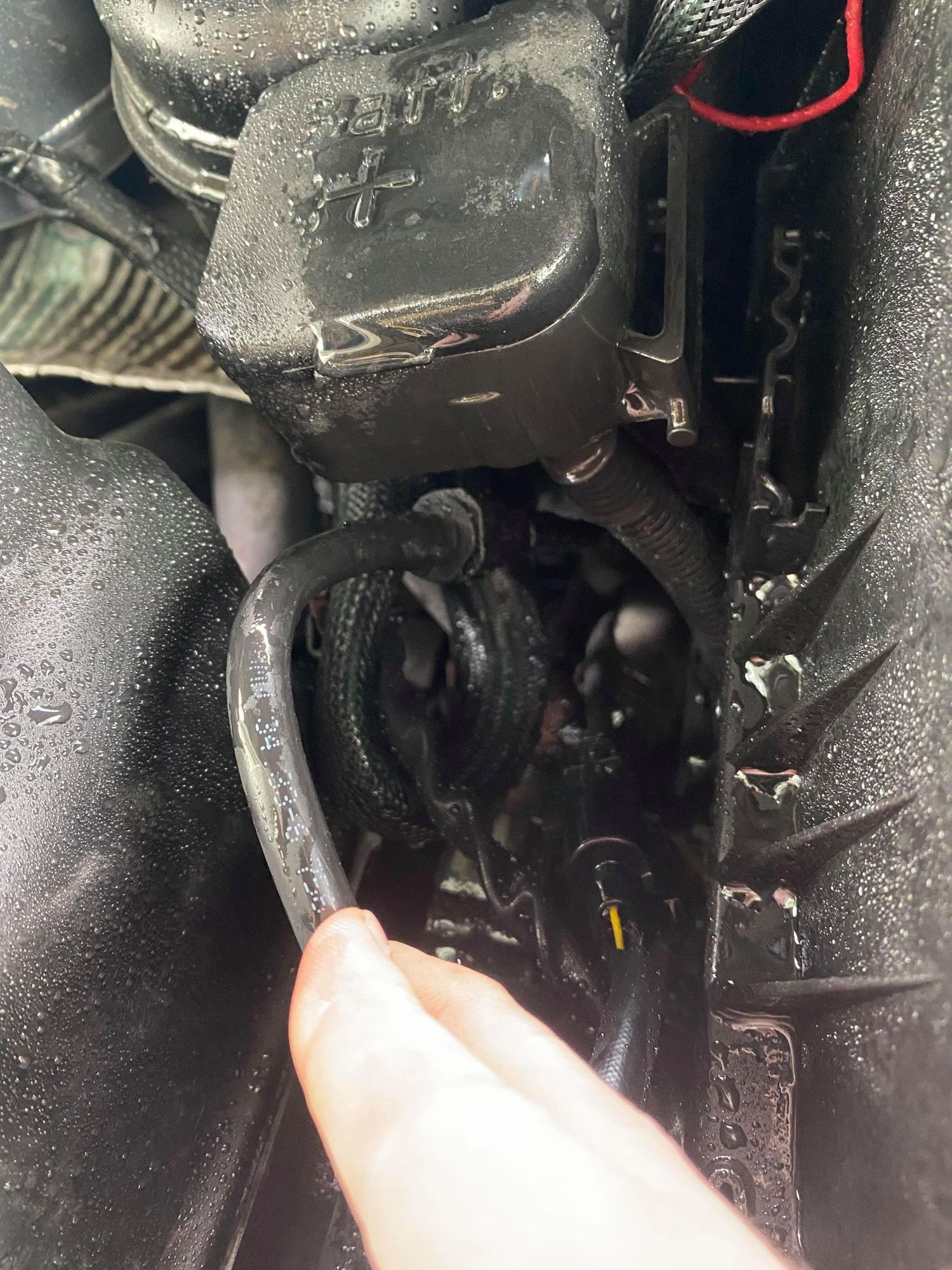

Okay so I have a 2002 mini cooper S and I've been chasing this problem for about a year on and off. If I got to a drive-thru, almost every time while I'm waiting, my idle will begin to fluctuate and almost stall. I am also seeing a p2096 which I originally thought was due to my cat delete(I have a defouler that worked for about a year, then this code popped up) but this idle issue has been going on ever since I've owned the car. I talked to a few people on here who suggested it might be caused by a vacuum leak. So I went out this morning and sprayed the engine compartment with water/brake cleaner(although I wouldn't recommend spraying flammable liquids into your engine bay, this is how I found something) and I sprayed next to the air box right underneath the positive battery post, and my idle started dropping dramatically almost stalling. I tested this three times in a row to make sure it wasn't a fluke. After I was sure, I grabbed a flashlight to inspect, started the car back up, and after spraying again, nothing. So I'm wondering if there is a vacuum line in that area that may only be open at certain cycles of the ecu? like the purge valve? But as far as I can see the only vacuum line over there is for the brake booster. I'll attach a photo of where I was finding this leak. IF anyone has any ideas PLEASE let me know. This has been plaguing me for years! Thanks!
the line I'm touching is the only line I clearly see(I sprayed the fitting like crazy and didn't get any Idle issue after I restarted)
