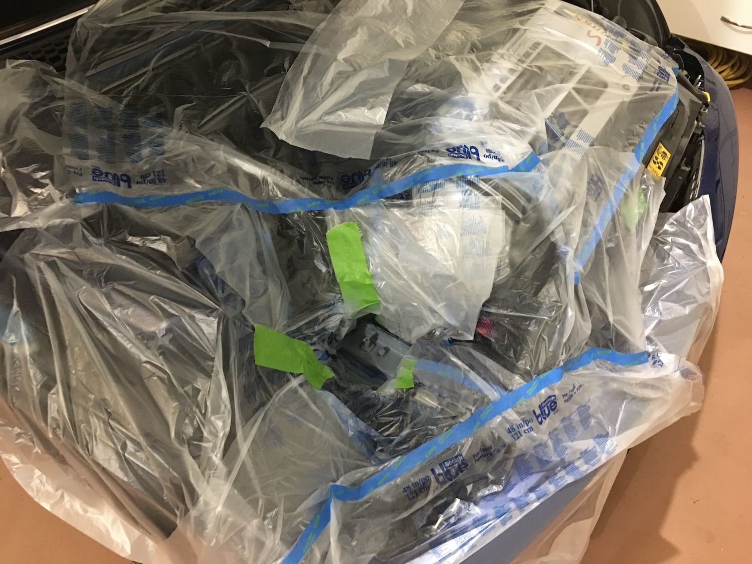

I don't drive my Mini in the rain, unless I'm caught by surprise while out, so it doesn't get wet a lot. There's nothing I can do, however, to mitigate humidity and holy cow has it been humid here this summer. The point being that the ground stud surgery left exposed bare metal on the frame that I wanted to address quickly. So Sunday I put a couple of coats of primer on that area. The color coat can wait until I'm ready to do a more comprehensive engine bay spray. As the photo shows, I wanted to make sure there was no overspray in unintended places.

Holy plastic wrap Batman….

Good job - yep, overspray can and will make you do more work! Can't be too careful!
