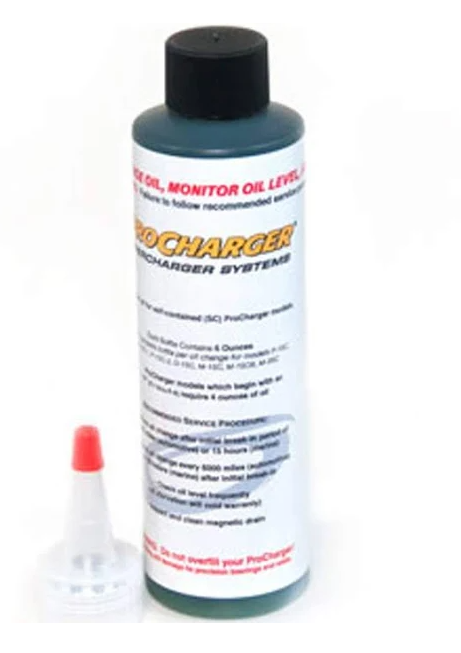

I spent a while on google image search looking for blue supercharger oil, and didn't see any direct results, but found a potential culprit:
Anyone have any experience with procharger oil?

Nevermind. Just watched a video on someone doing a procharger oil change and that stuff is like water. Definitely not what was in mine.
