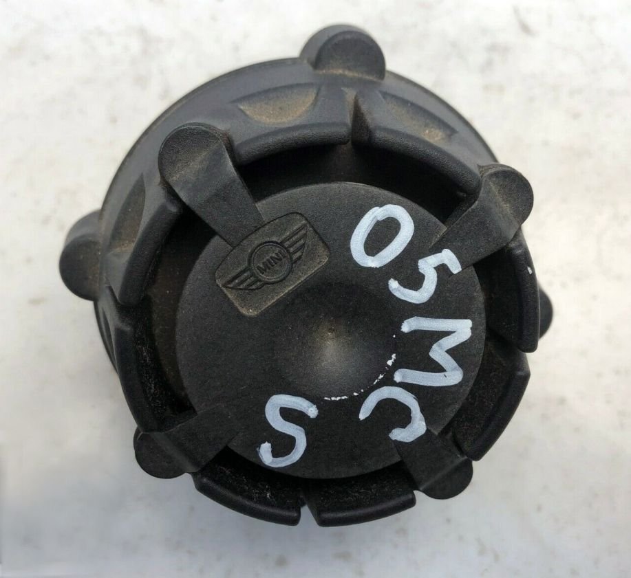

I've been doing a significant amount of repairs to my Mini lately R&R(ing) with new parts. I finally decided to look into the siren alarm. Replacement part = $150 -$200...for something that makes noise.
So, I removed and took my old one apart. Thinking that I may have been a little rough pulling the two halves apart - I discovered a detached negative wire underneath the breadboard. Soldered it back in to place (thinking it couldn't be that simple of a fix) and installed it back in the car.
What do you know? - It works!

FYI - I neglected to photograph the procedural fix because I never expected it to work. Siren Alarm designs and pinouts vary from year to year; Below, I've uploaded images of siren alarm that matches my '04 MCS
(I purchased this one from Ebay before I managed the fix to my original )...
