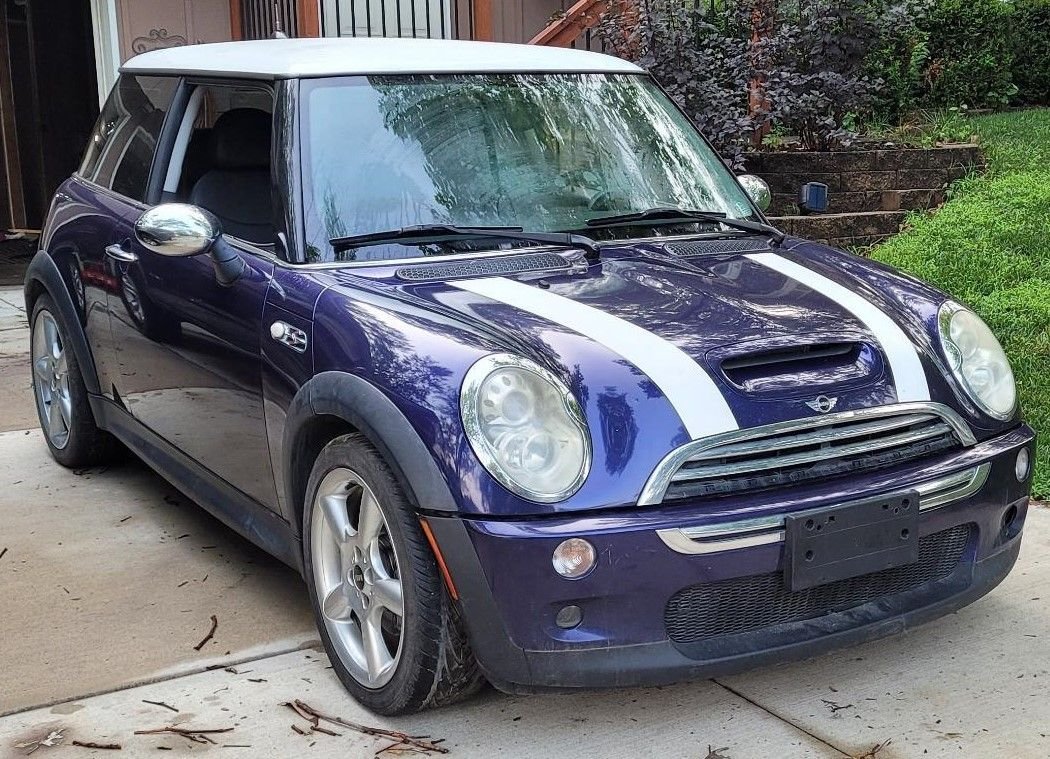

Hey Everyone,
I recently purchased a 2005 MCS from a local autoshop. The previous owner did a bunch of mods, tuned it, and then blew the engine and couldn't afford the repairs. So it sat for 3 years until the mechanics lien was processed and the shop was able to sell it. I have torn it down and the block, head, and crank are at a machine shop for inspection and repair if required. I asked around and it looks like the car was tuned by Jan at RMW, I have reached out to him via email and phone but cant get ahold of him. From what I gather this seems to be par for the course.
I checked the Dimsport tuner logs and the last thing it registered was flashing a 450cc injector tune, the injectors are the same ones Jan sells on his website. Since the ECU has a tune on it that may have contributed to the failure I would really want to have a stock tune on it when I try to fire it back up for the first time in 3 years. So I have a couple questions:
1) Is there a way to "recover" the stock tune? Or is there a way to download a stock tune based on my vin?
2) The cam that was in the car at the time of the failure has different markings than what I think a stock camshaft should have, any good resource to identify what it is?
Thanks in advance.
