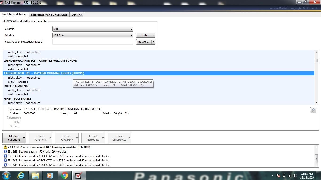

It's just a matter of coding of Body Computer, using NCS Expert .
