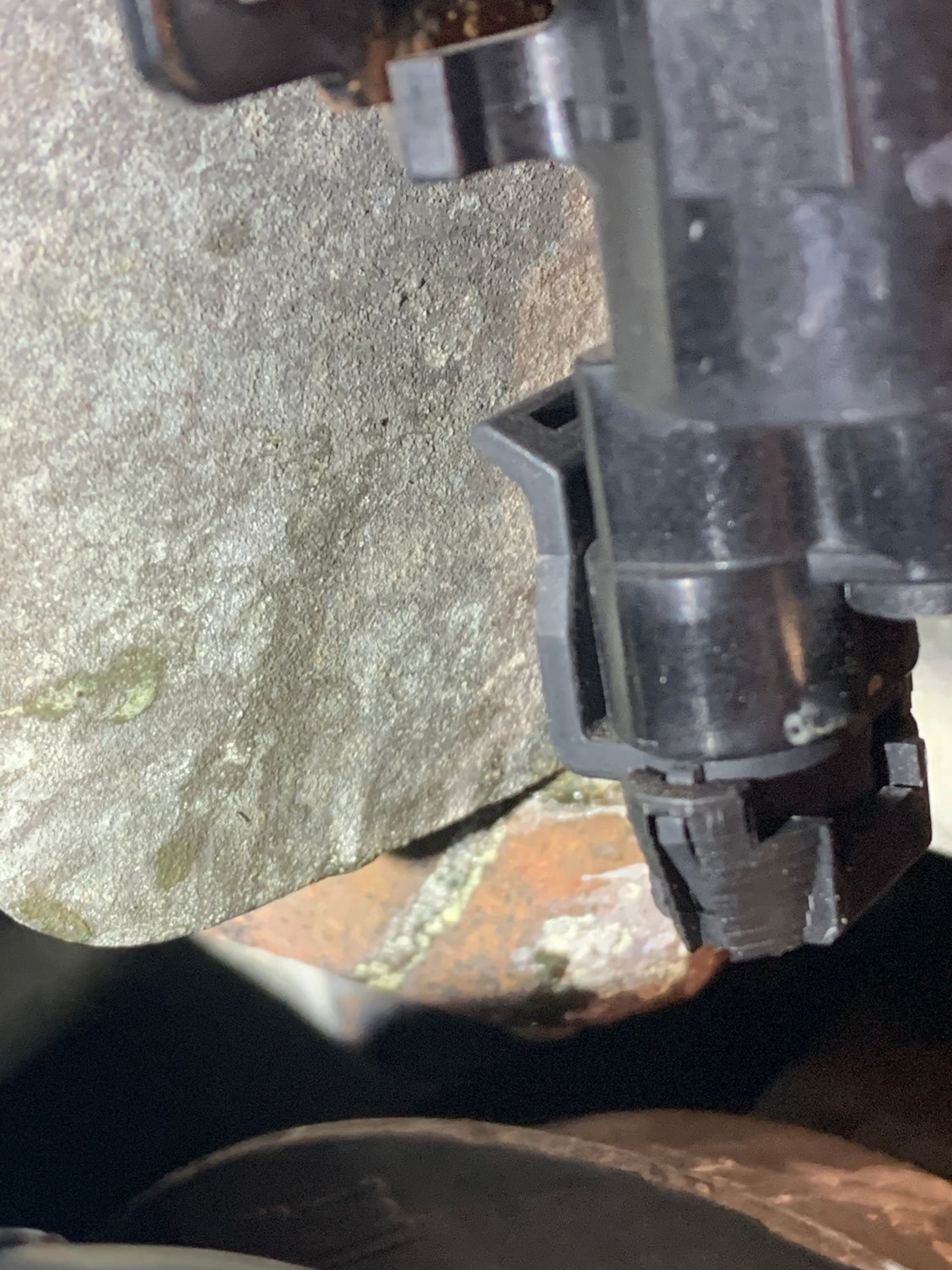

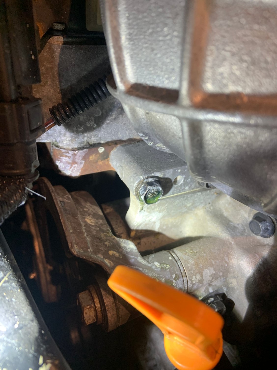

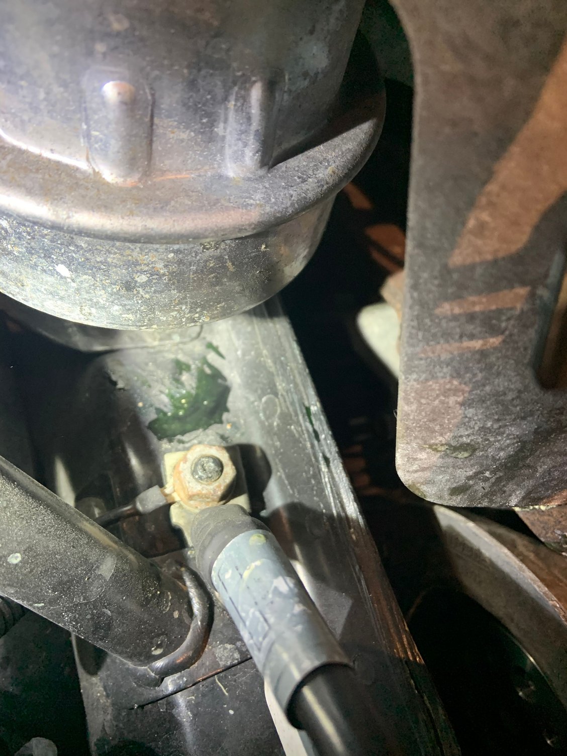

I’ve noticed my 05 R53 has been slightly down in power and I have a vibration at high rpm. I checked my oil today and was down a quart with only a 1000 miles since I changed it. Filled that up and checked the coolant level and that’s fine, but when i pulled it in the garage I can smell coolant and found some splatter under the engine mount and on the bolt behind the dipstick. So head gasket going?

Thanks! I think I might have found it. After further inspection it looks to be coming from the top radiator hose and blowing back into those areas. Then I thought about the performance and a couple days before I had to fill up with 90 octane instead of the 93 that I always get. This car has lots of mods on it including a custom tune and noticed right when I’d get into the boost I’d head a slight detonation and would assume the ECU would compensate by backing off the timing thus loosing performance. Last night I filled back up with 93 but haven’t had a chance to drive it long enough. And looking around for the coolant issue I noticed I had oil running down from the crank and dripping g off the pan so I pulled the balancer (ATI) and could spin the crank seal with a screwdriver lol. So I think that’s where my oil drop went as well.
