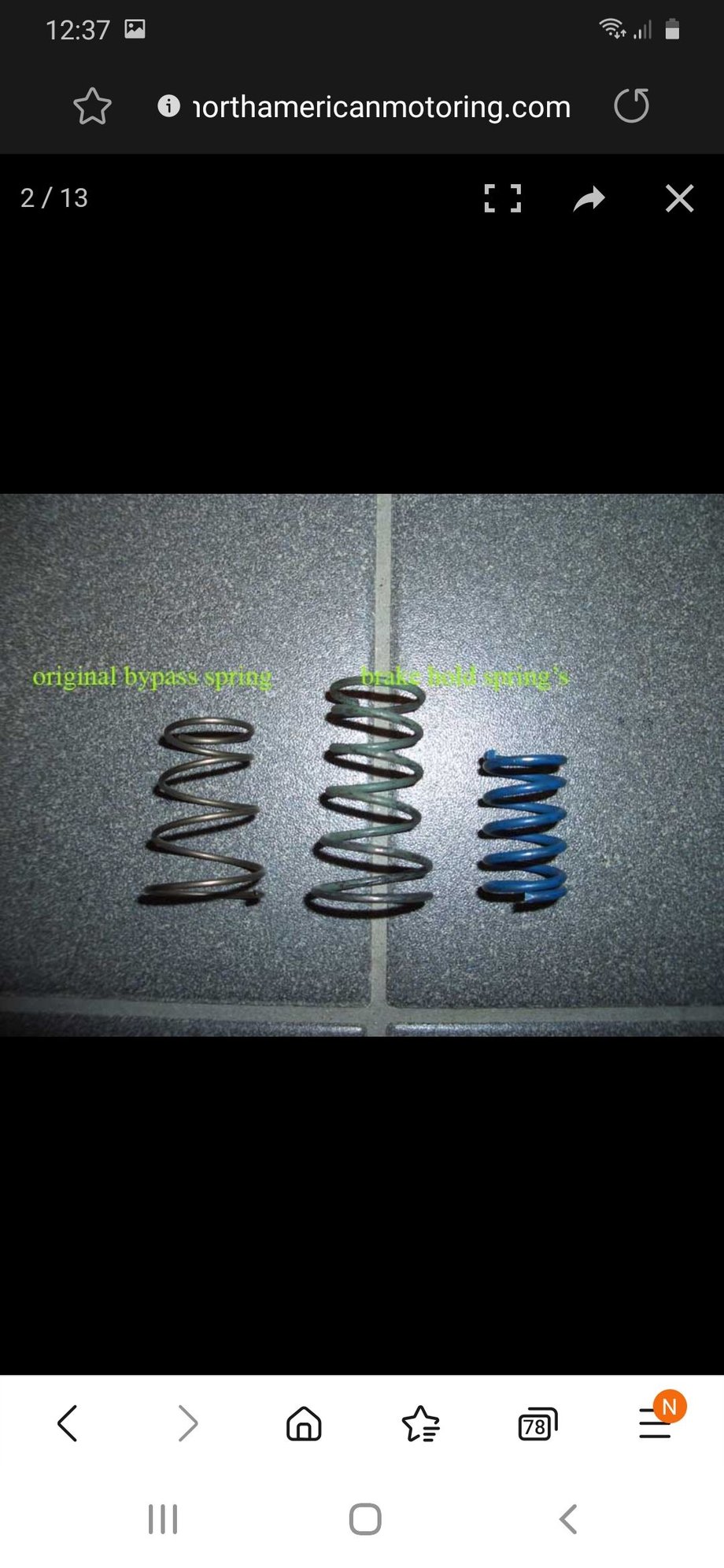

I have finish work on my mini...changed the clutch,refurbished flying wheel,it was worn,now is brand new,reolace the top engine gasket,in fact i have replaced all seals on the engine,put ac delco oil into s/c ,and done job with the bpv...
i had some ideeas...first time i have canceled the vacuum hose of this bpv,and took vacuum from pressure fuel regulator...with a "T" and replace the spring with a stiff one...with that stiff spring...the valve was all the time in closed position,took out and...now is the tricky part...put back the old spring inside the other spring...so...i have 2 springs 🤘🤪.
i have refurbished also the hoses from steering rack...replace the oil...but now i have a stiff wheel...
