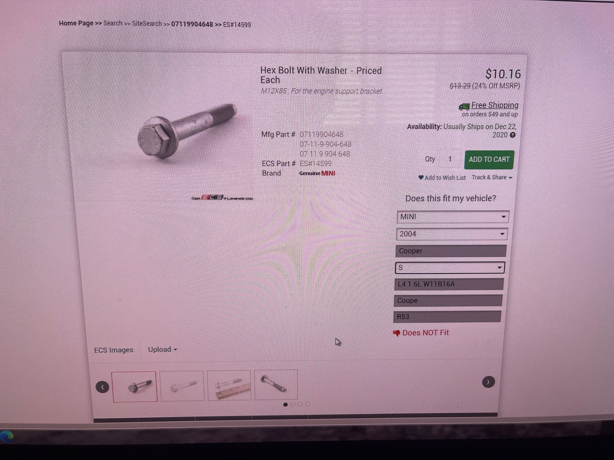

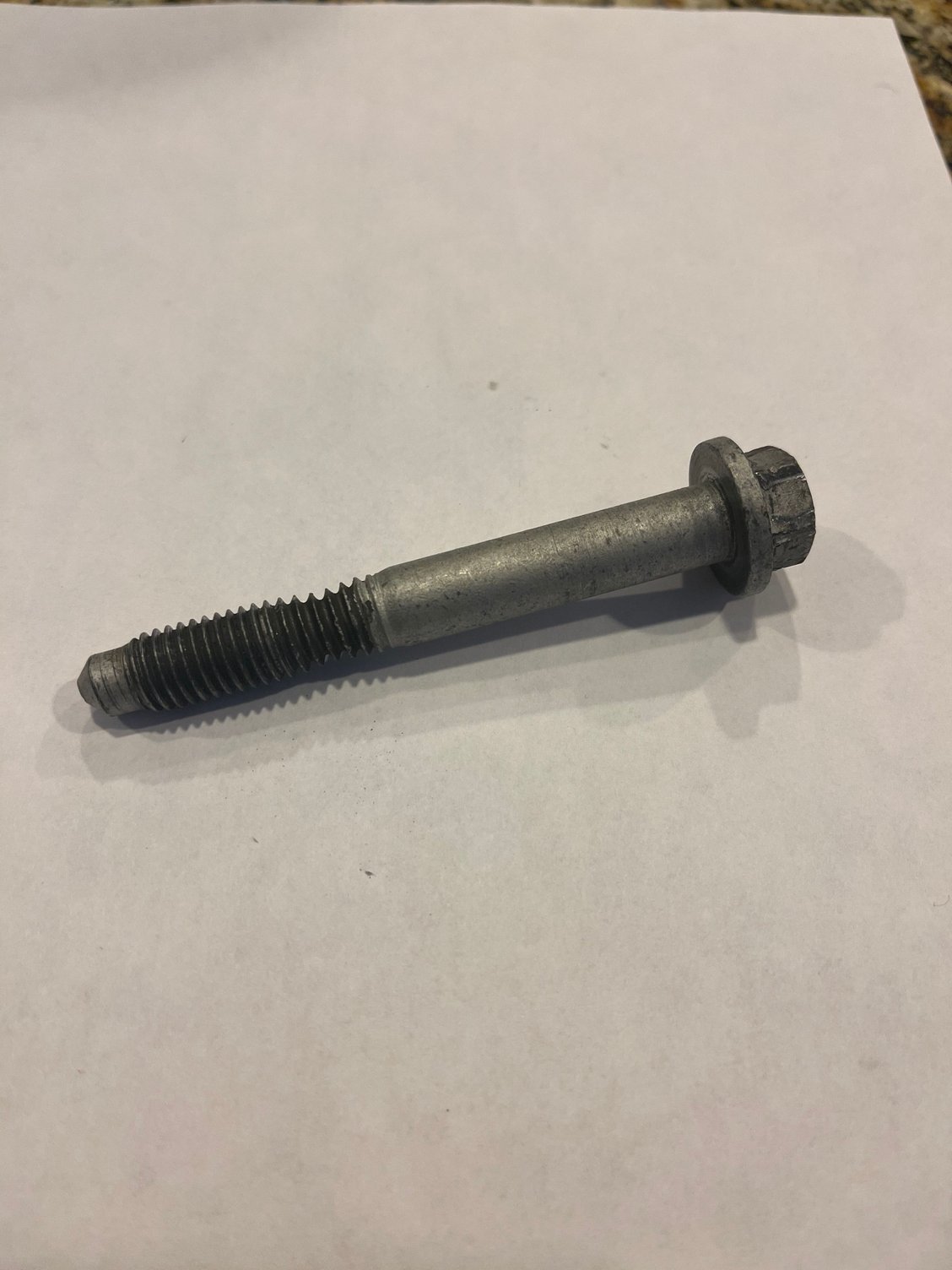

This is what it looks like, but I’m not the original owner so I don’t know if the wrong bolts were previously used, however , when I use the part number from the realoem site and plug it into ecs it says it doesn’t fit vehicle. Could I use any M12 bolt that’s the proper length? The one I have is a M12 8.8 and 93-94 stretched.

The bolt you have displayed is an M12x85 (if it's #2 in the illustration).

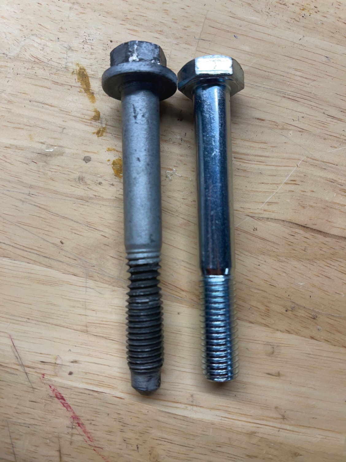

Yes, that’s the bolts I ordered dispute esc site saying it doesn’t fit my car. Crazy expensive for a bolt, I ordered 6 so I have 2 backups for down the road. I put the one next to the stretched one in that I picked up at Lowe’s. It’s a 10.9 hardness in lieu of an 8.8. Just to hold (not driving) until new ones arrive. I imagine they used 8.8 for a reason, guessing harder would be too brittle for motor vibration.

Just so you know, the M10x20 bolts (#10 on the illustration) I referenced are for the bottom engine bracket (attached to the oil pan). Ace Hardware is a great place to buy hardened Grade 8 bolts - great selection also.

Fixed that on the site. Sorry about that. #2 M12X85 , dont see anything in exact match that we carry in aftermarket, just checked some supplier. That bolt has a contour section
