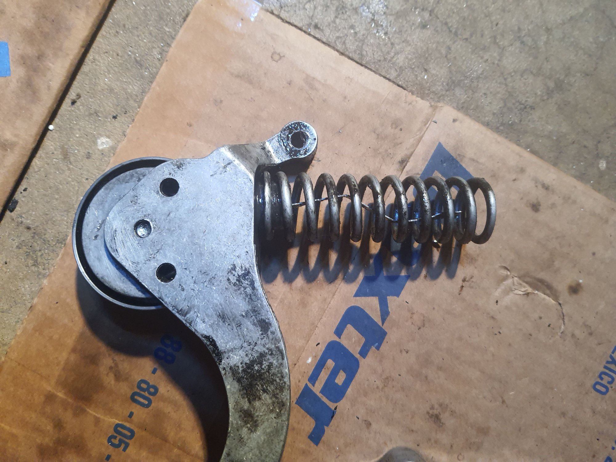

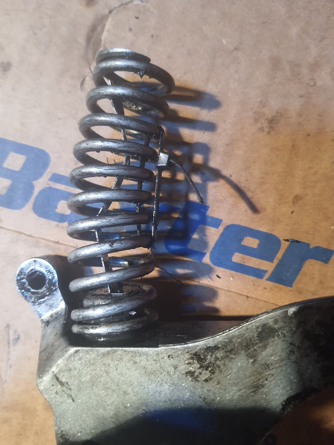

Well good news and bad news... GOOD NEWS: the supercharger ran JUST fine for about 1min..BAD NEWS : my belt was jumping a groove on my supercharger pulley so I thought I didn't install the pulley correct or somehow it was wrecked. I put on my back up sc and exact same issue.
I looked better and see that my tensioner pulley is slightly cooked and spaced abit wrong.. could it have gotten bent or damaged when my sc went out or taking it on and off so much ? I tried EVERYTHING and no luck so I guess I gotta bite the bullet and buy a new stock tensioner and belt tool as I'm sure my current one and alta tensioner are shot , plus it be kinda nice to go back to a stock system I hope though I don't get belt slip OR I will buy another alta tensioner for the new tensioner...so I guess this thread is dead now. Thx for the help guys , lol onto ANOTHER problem . Lol what an avalanche of problems I had since the head n cam..I literally had but 1 issues 14 months owning the car. And now all this , well I definitely know how to work on this engine now though atleast...

I think a new tensioner is a good idea. Also check the other pulleys just to be sure.

Lol derderder me or my guy musta forgot to cut off the other zip tie we put on the tensioner because we did it to keep it compressed to get it back on n lined up..lol I do only remember snipping off one, derderder. That I think would explain my lack of tension and why I had to tighten my belt more than normal which made it jump a grove on the sc pulley until it went all the way over and hit and blew out the sc seal and then the belt shredded... God I feel like an idiot , I caused my self soooooo much extra work
you guys think that being the spring crooked like that would have been casing my belt alignment issues ? I put a atrait edge on the pullies and they're all in line from what I can tell..so I'm pulling the trigger on a new tensioner and belt tool..

Jep, get a new one

will order it and the belt tool tonight . Though I'm pretty sure my alta tensioner is fine so if for some reason I have belt slip issues , which seems to be the biggest issue with smaller pullies , I will then reinstall the alta adjustable rod into the new tensioner then.

After ready through this entire post.....I've come to the conclusion that 90% of your issues are self induced.

welllllllllllllllll , I will not argue that . I DID leave that zip tie on AND I did pinch and cut the crank sensor wire sooooo. Yes , the issues were my fault .
But in all fairness we had to rig back on my tensioner without the tool AND it was already kinda shotty.
but yes had I took a little extra time all this could have been avoided. BUT in all fairness each time the car came apart it got better parts like new coolant hoses or all new sensors belt and now a tensioner, o yea and a ported sc
Agh well, no point crying over spilt milk...
that is a big reason I usually work on my car alone so things don't go over looked and I try not to work on it when its late at like 2am. Thats when I tend to do dumb dumbs.
