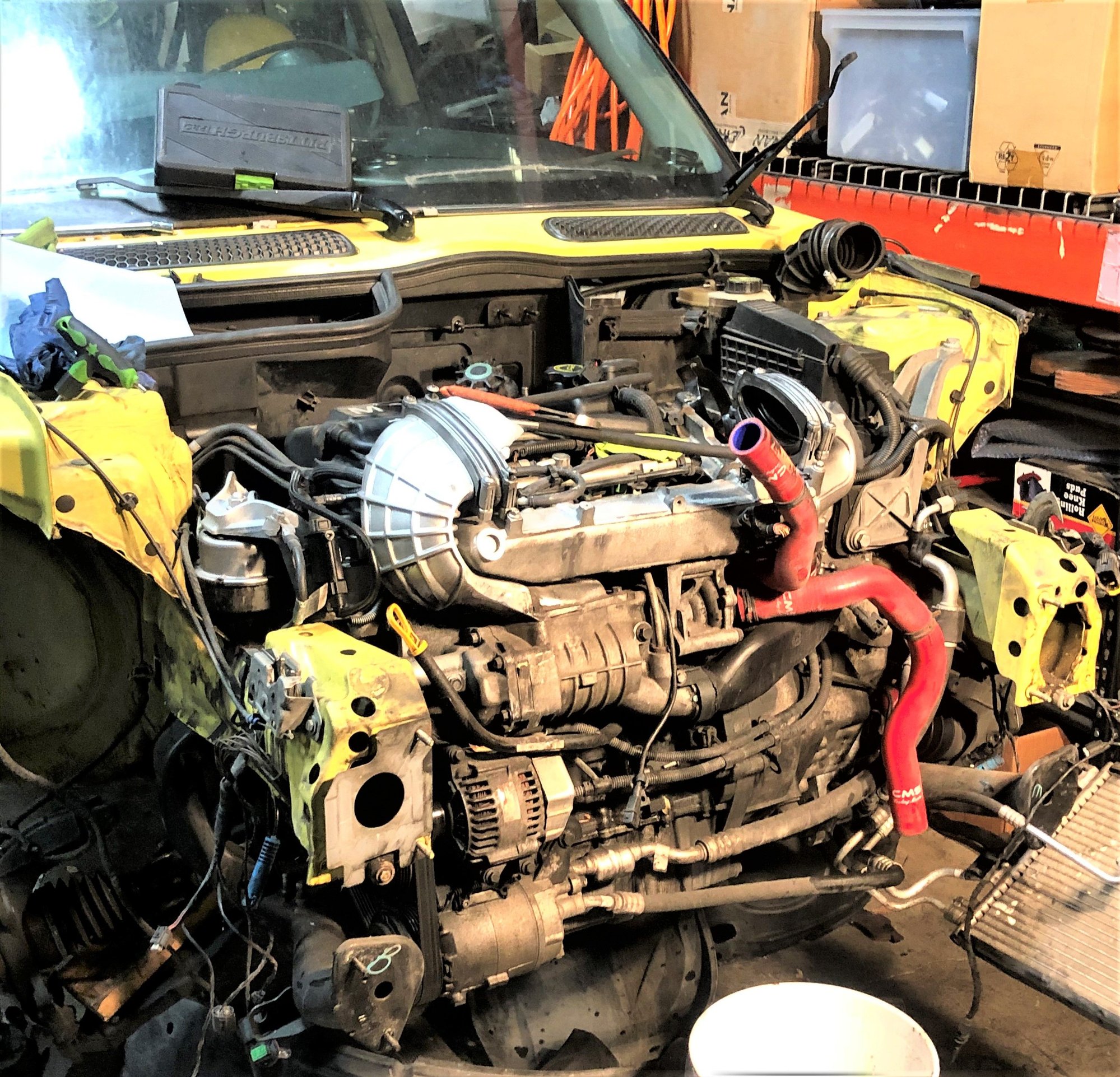

Quick Update: So, the clutch did completely go boom - so to speak. Not sure I mentioned that yet. Anyway, I had to transport the car to the workshop today. I was able to drive it in, when I say drive, I should say it was more of an adventure / mis adventure. From cold start, first thing in the morning, the car drove okay - shifted into gears and all and clutch would engage at like stop lights, etc. Once it was warmed up though and after a few miles, I had to rev match to make it up / down shift while driving. I unfortunately hit a bad patch of traffic just before my destination which did not help at all.
Once I got to my destination, I turned the car off to get the space ready for it - it would not start up again. It will now not start up at all - zero crank. It just clicks when the clutch is engaged or the pedal is pushed down. Battery seems fine. Is there a clutch safety switch that may have gone bad or did I just kill the car? I am now debating between fixing it, using parts from the donor car, selling it as if - not sure if anyone would want it (The issues would of course be fully disclosed), or just have fun and part it out. If I part it out, i'd keep the cool stuff and see if I might want another R53 MCS.

Strange that the car isn’t starting now. It could be the clutch switch, but check the ground cable on the passenger frame rail since it only takes a few seconds and a lot of non-start issues have been solved by making sure this connection is good and tight.
Not sure if it’s been answered yet, but ‘06 transmissions have lower 1st and 2nd gearing than prexfacelift cars. Retrofitting these 6 speeds on a pre-facelift car is a popular mod. Have you run the ViN on the ‘06 to see if it has a factory LSD?
Also, the thing about the ‘06 supercharger is it should have a different coating on the rotors to slightly improve the boost or efficiency. The facelift superchargers were JCW superchargers with stock sized pulleys.

I am currently debating if it's worth it to put time, effort and more money into this car. Of course, I am on a MINI Forum, so it is kinda a big ask since we love these cars. However, at 155K miles on the clock and what now seems to be dodgy maintenance history, should I just put the fun parts aside, part it out or get rid of it and seek a nicer example down the line?
One argument possibly in favour of the car is I do have a parts car, however it is a 2006 and so there are some differences in the cars. So far, I have taken wheels, coil over suspension, Rear Sway Bar (To be installed), DINAN Exhaust, DINAN Intake, adjustable rear control arms and some other bits and ends. If decide to fix the 2004, this would involve swapping the transmission, from the 2006 along with the clutch, then the reduction S/C pulley along with some more bits and bobbins.
