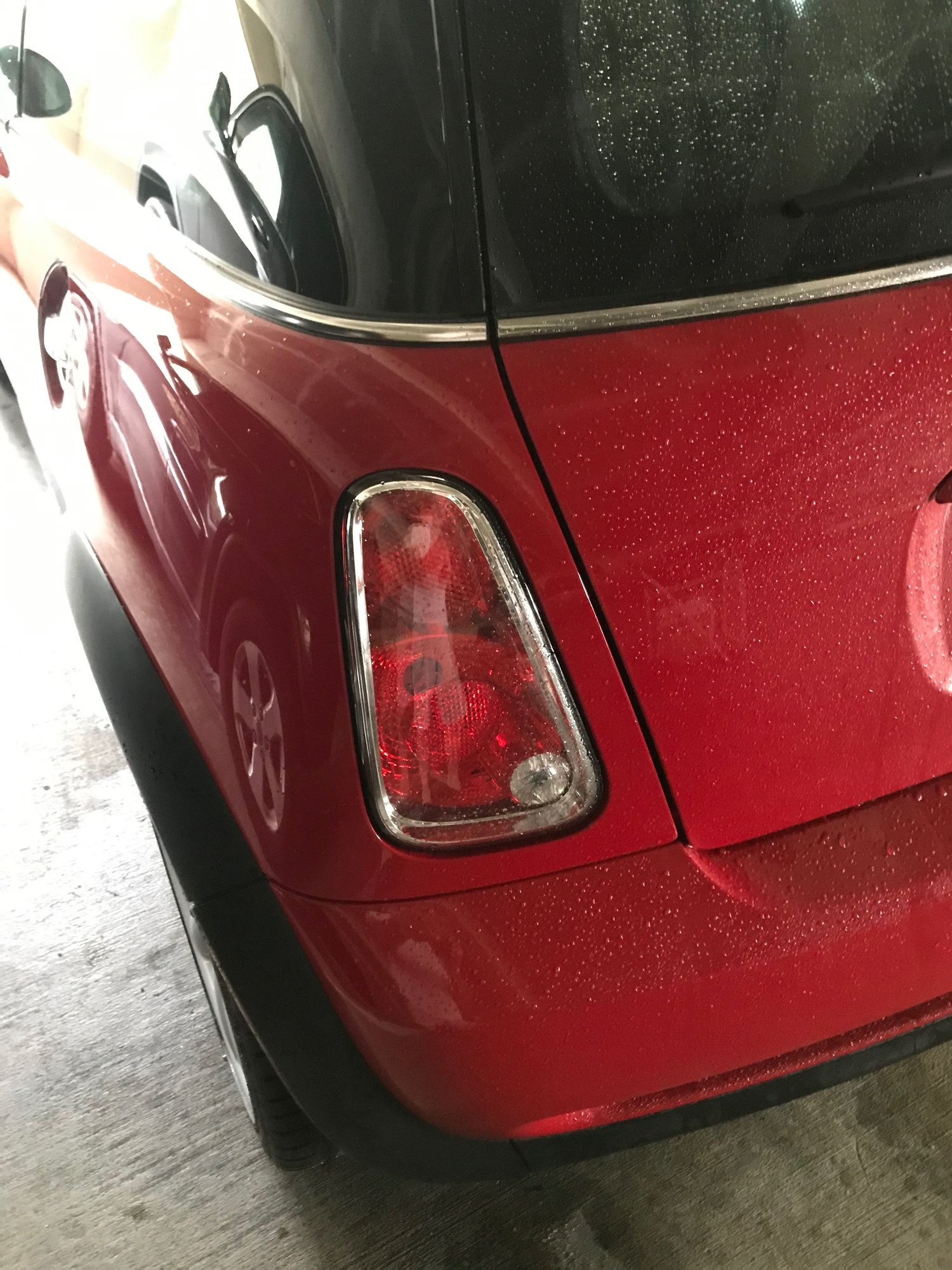

Monday greets!
New tail lamps from Way Motor....before and after (on a rainy morning). I am totally happy, the pictures don't do the refreshing justice. The leaking antenna issue was addressed, too. First, the rear sunroof drains were checked ( no clog..), and so the mechanic (Jim).. cranked down the interior bolt slightly ( the bolt that attaches the antenna to the roof). I am to keep an eyeball..or two..on it.
No charge today..so I passed Jim some cash ( a fifty). I'm grateful to have been recommended this repair facility.
Next, I need my headlamps to look flawless.
to be continued.........
