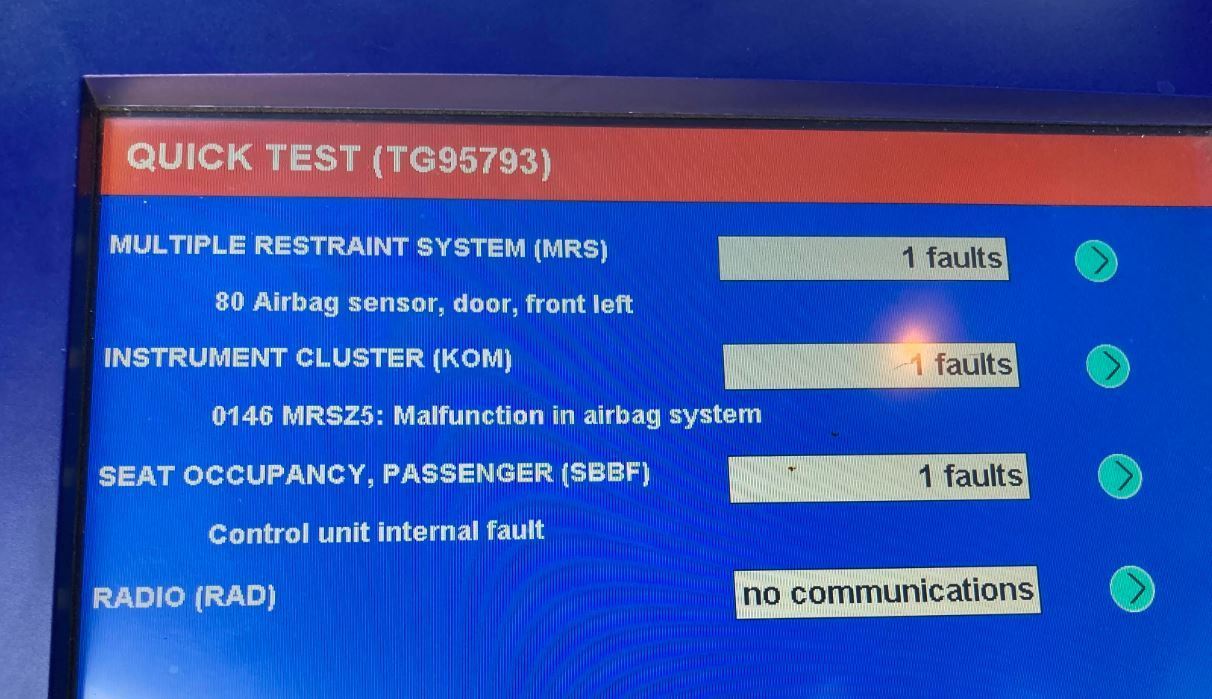

I stopped by a shop today to get a scan with a better scan tool than I have at home. Here's the results.
Occupancy sensor was replaced under warranty in 2017, so not sure why that's coming up again?
I don't know much about the driver's door airbag sensor. Could it be a connector? A fuse?

I pulled the driver's door apart today to check the "80 Airbag sensor, door, front left". I unplugged and plugged the connector into it 3 times, but that didn't seem to help anything. I've ordered a new one to see if replacing it helps.
Still don't know what the 0146 MRSZ5 issue is?

Made some progress here. Used NCS Expert to code out the occupancy sensor so airbag will go off regardless. Cleared that code with INPA.
Now, hoping that the new replacement door airbag sensor will solve that code!! If not, I'll be back to square one.

Good news! Fixed the other half of the airbag light issue and now the light is off! Replaced the driver's door airbag sensor with a new one. Didn't ever require clearing codes afterwards, it cleared itself after startup.
