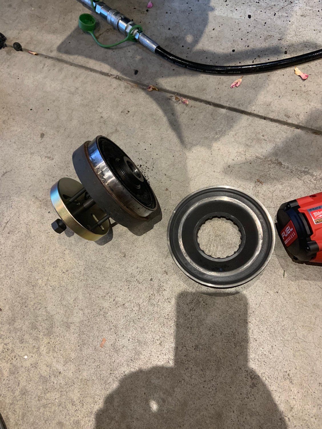

First off I have two ‘05 R53 Minis, one is for work and the other is a low mileage jewel. So today I changed the oil in the jewel and after I finished I took it for a drive. Only mods for this one is a Miltek Exhaust a CAI and a 16% pulley. For some reason this car pulls hard and gets 18# of boost. Well today I stayed in the throttle to redline and hit 20# of boost on the gauge then acted like someone turned it off and smelled rubber big time. Check engine light came on with the two bottom lights in the main cluster and would not rev over 1800 rpm and limped it home at 12 mph. Put the scanner on it and came up with Cruise and throttle body something. I figured it slipped a belt but was still there. I cleared the codes and took it for another drive. Runs the same but can’t get over 10# of boost and can hear a squeal hear and there. I just removed the belt and looks fine do I don’t know what happened?? Please help.

Sounds like your crank pulley gave out. Very typical on these cars. The rubber dry rots, and causes the pulley to separate the two halves

See this thread and check out the video for diy replacement, including footage of the pulley separating in two pieces at 6:50.
https://www.northamericanmotoring.co...ing-maybe.html

oh I didn’t think about that yeah I bet that’s it. Thank you!!

+1 on the crank pulley. Do yourself a favor and replace with a fluid filled unit, either PRW or ATI. It's a much better part and should provide a smoother idle.

Yep that was it.
