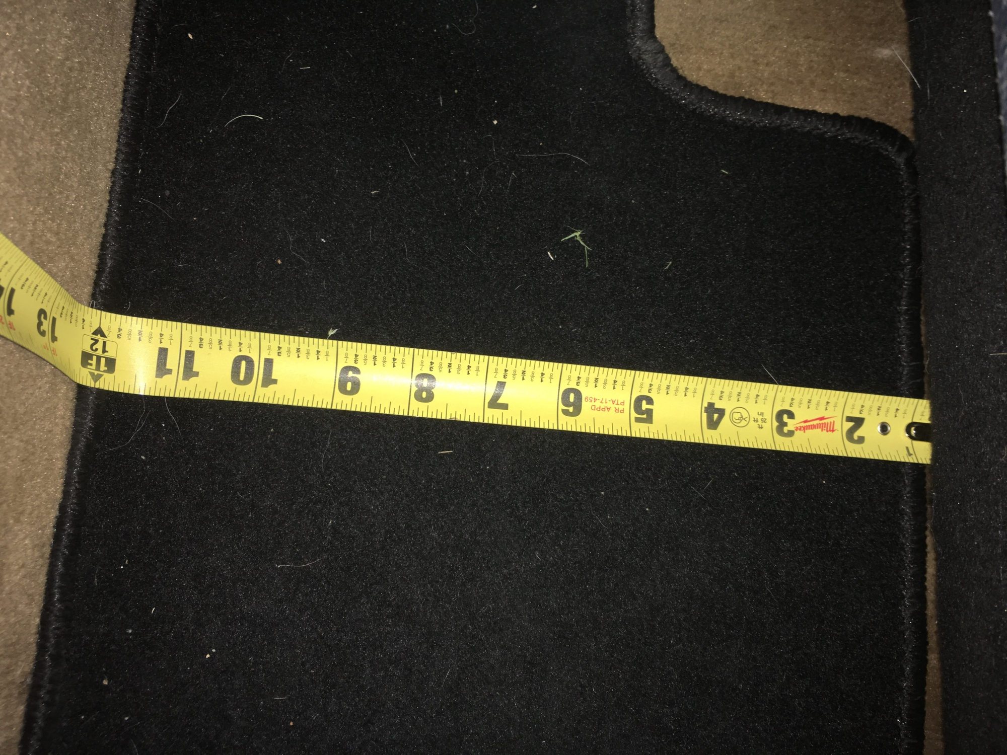

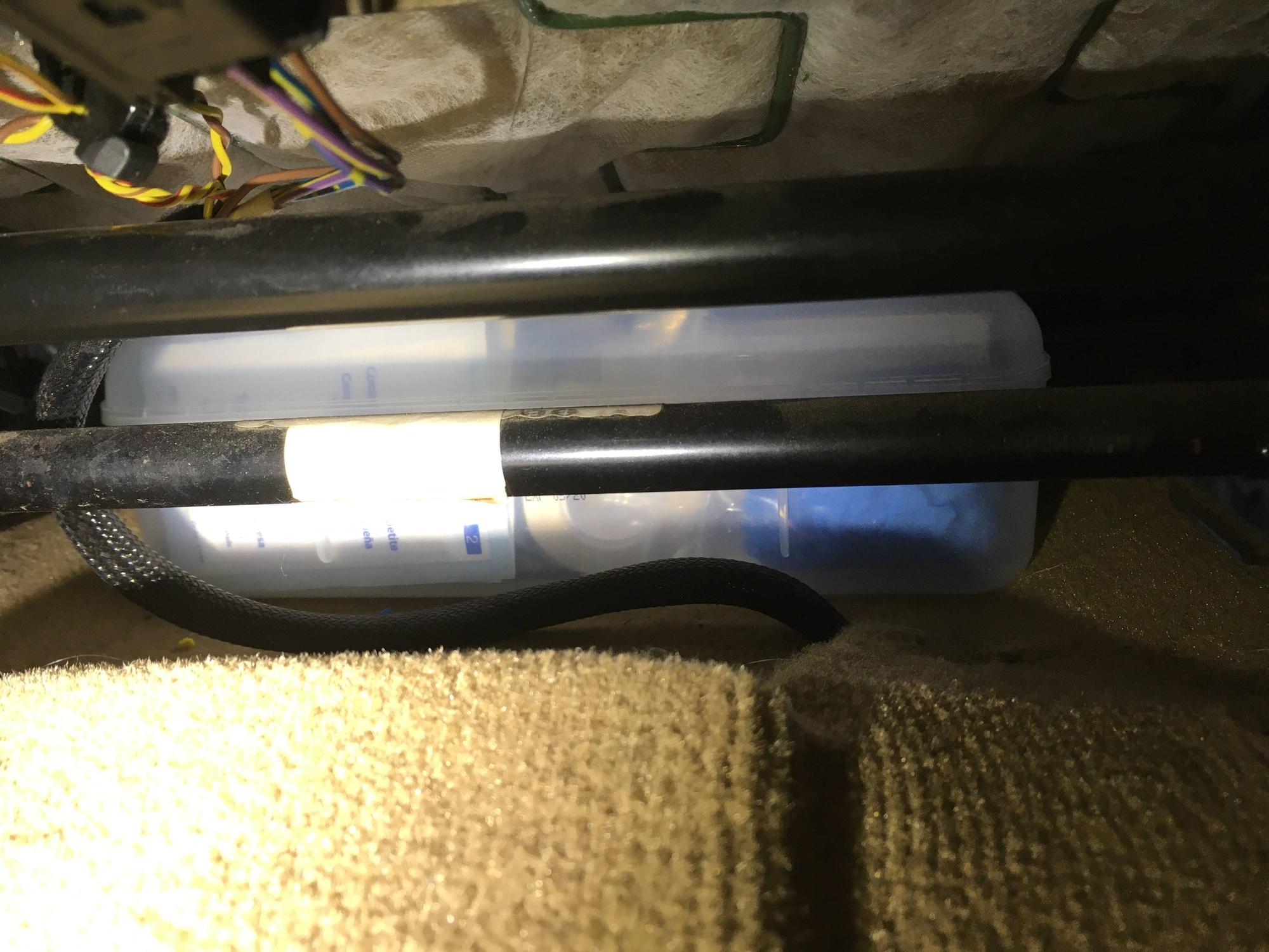

Enclosure size will depend how far back into the rear passenger space you want to encroach, and height of course will depend where you set your seat. Worst case you have 3"
The under seat air vent is 20" from the back of the rear footwell. With my 7x10x3" box in place there is about 12" of space for the passengers feet.
There is next to no room under the passengers seat as there is indeed a module already under there taking up most of the space. (HK amp maybe?)
Remember, if you take the seats out to make installing easier, unplug the battery first so you dont trip the airbag light. Some pictures attached for you.
View from front of 7x10x3" high box under front driver seat. Very little clearance above the box.
View from back showing under seat vent at front of space,. and seat wiring harness. Note the intrusion of seat mechanisms into side to side space that limits available width. Seat has to be raised to provide enough height clearance to slide box in or out.
12" of space until making contact with box, thats the space for any rear passengers feet.

Really appreciate the pictures, noticed you replied to my other thread as well, thank you. I was actually about to go measure for myself, I had attempted to previously but it's pretty dark under there and my phone flashlight doesn't seem to do much so I wasn't sure my measurements were accurate, this gives me reassurance though.
