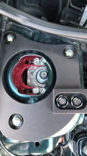

Let me see some pictures of your camber plates. I took my car to a specialty shop and I’m curious if both side of your camber plates are set the same. Mine are not. I wish I took pics of it when I first picked it up, because I swear they were petty much the same. I called and they told me it’s rare they are exactly the same.
what’s a good phone app to use with my iPhone to check the camber angles because just eyeing it the passenger side appears to have more of an angle.

Mine aren't equal. I believe my driver's side strut is farther inward than the passenger side to get -1.5° of camber on both sides.

Its pretty clear in the head on shot that the camber isn't equal on each side. Its more than likely the setting won't be the same since cars aren't swiss watches and will require different settings to achieve the same negative camber setting. It is possible the setting in the strut tower wasn't totally tightened and a bump knocked it loose or off even though it shouldn't.......

It was off. I used a large carpenter square and it was off quite a bit. It must have not been tightened enough and the 4 hr drive home of bad California Highway must have moved it.
Use that same square. Continue the straight edge to the top of each rim (of the wheel) and measure. Compare the two. Make the one not like the one you want, to be the one (measurement) that you want.
Trigonometry can be used here to determine the exact angle of your front camber by taking measurements and punching them into a calculator (based on two measured lengths and a known 90* angle).
