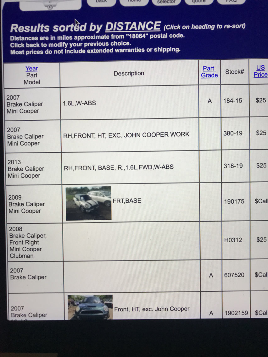

My local junkyard has a pair of 2007 Mini Cooper calipers. Are these what I need to do an r56 upgrade? They have the rotors also listed. Didn't see carriers, but I assume the have those too. Is it this easy or am I overlooking something?

R56 Cooper and R56 Cooper S brakes are two different sizes. You want the R56 Cooper S ones as it wouldn't be worth it for the non S ones.
You will also need our special brake lines to connect them to the factory hard lines without modifying the bracket on the body.
https://www.waymotorworks.com/stainl...rsion-kit.html
And don't bother buying and paying shipping on used rotors, just get new pads and rotors for the swap
https://www.waymotorworks.com/front-...rsion-kit.html

Thank you for helping. I read this is a common upgrade, its difficult to find what is actually needed to do it. This is helpful!
