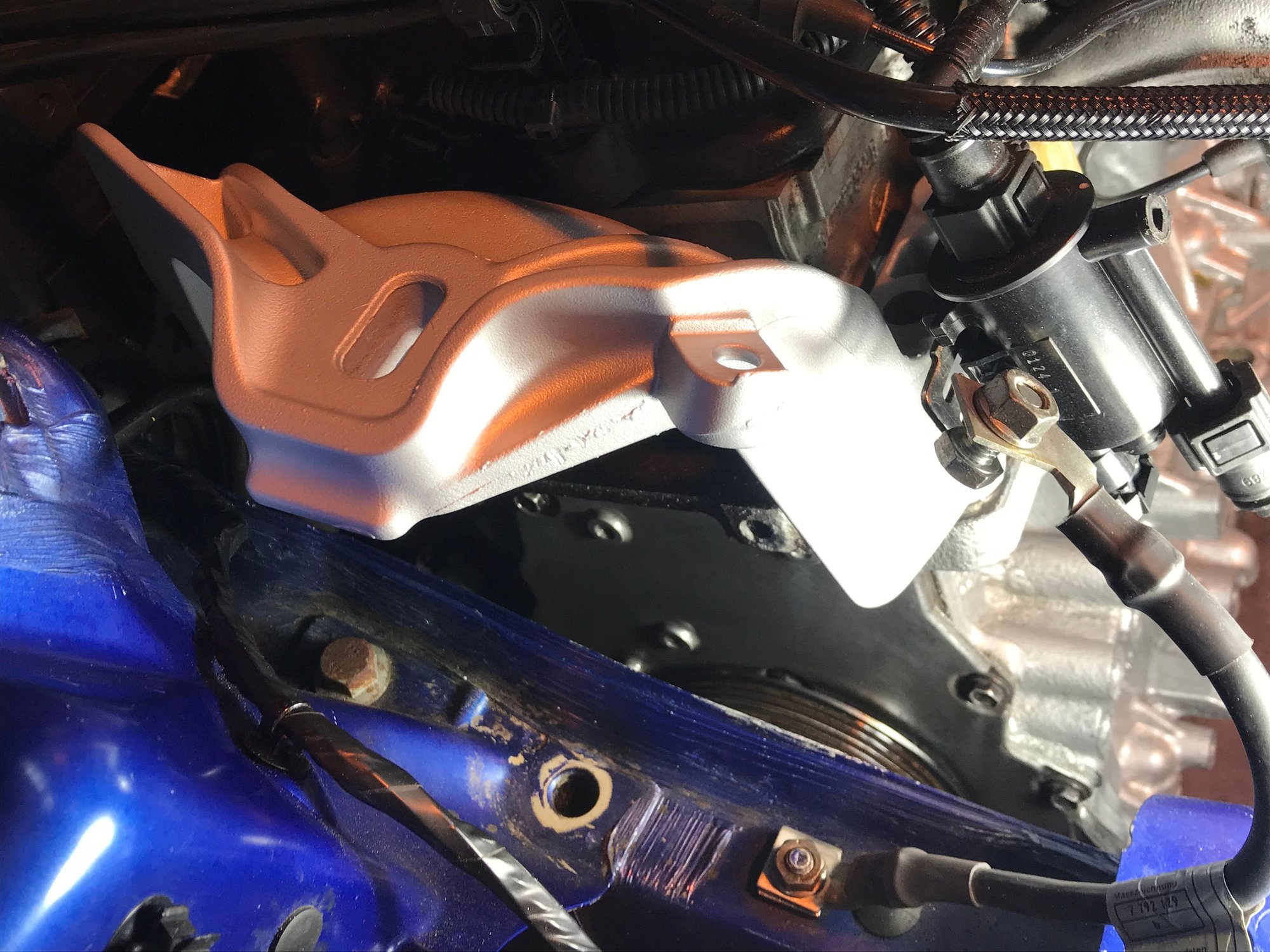

While everything is apart and while waiting for parts I've been tidying up the engine compartment.
Bead blasted the top engine mount and painted with "Alumina Blast paint and wire brushed the bolts and gave them a shot of Eastwood metal clear. Not a lot of shiny aftermarket but I won't be shy about popping the hood. After all it is a Bargain Mini...
Good thing it's not my daily driver!
Thanks again,
rob
Cleaned up that end of the block as well. A shot of metal clear on the aluminum and silver Por-15 on the block.
