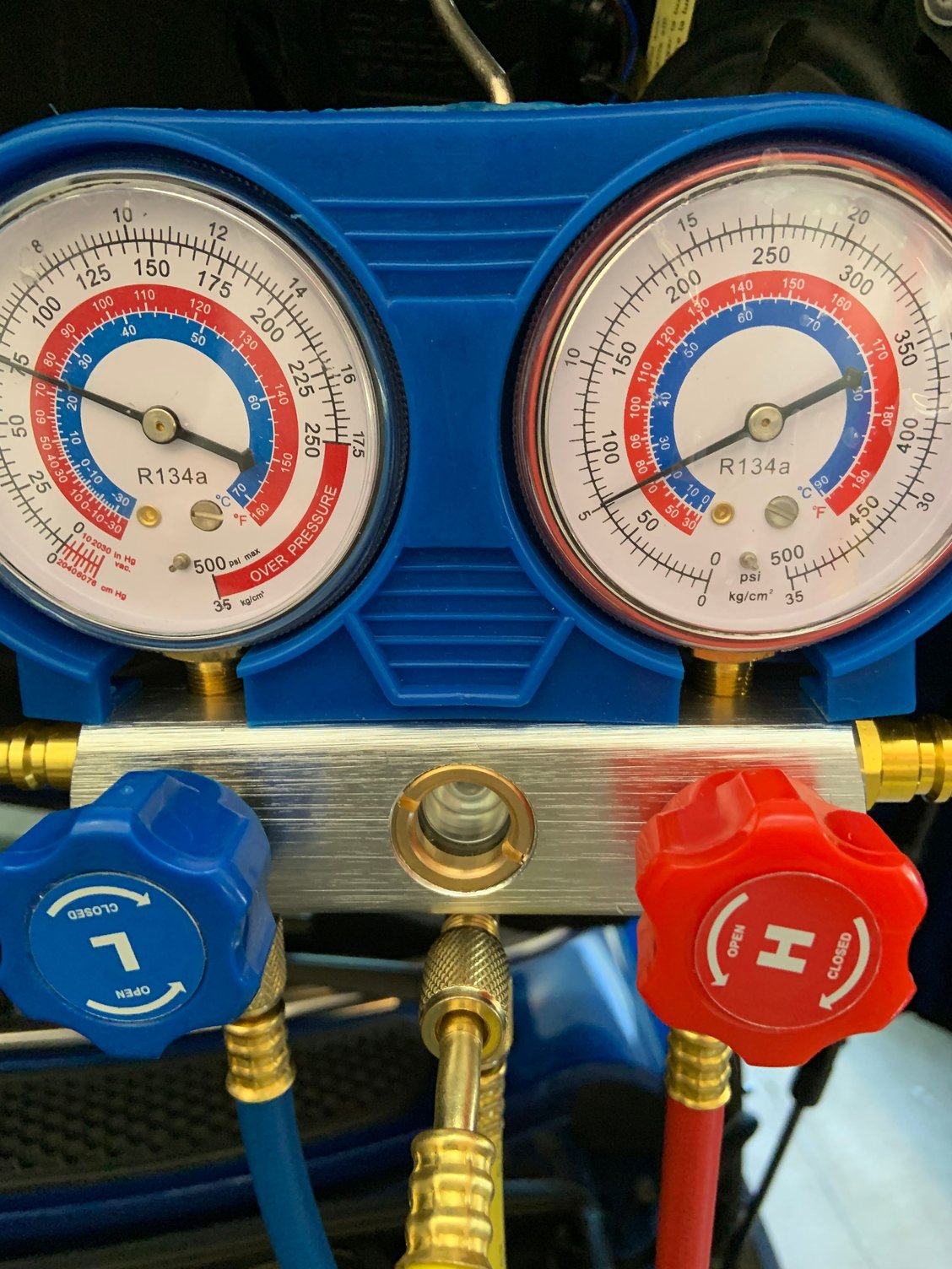

I finally got me some manifold gauges and the gauges read about 75 psi for both sides with the compressor running. Low side slightly drops when the fan comes on. From what I gathered it means it has a faulty compressor?? High side line is extremely hot so I know it’s pumping but low side is ambient temp. Any ideas? When I shut the car off it equalizes out.
