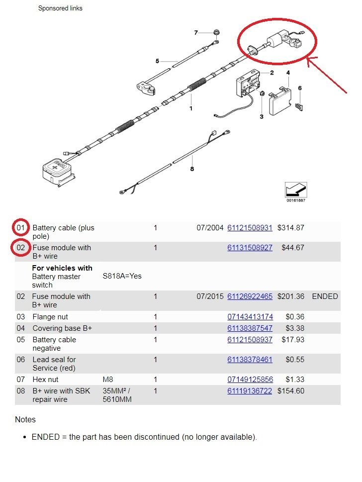

Sensors could be bad and got extra sensitive. Check positive terminal of battery cable. It has a small explosive device that disconnects the bigger positive wire. There are two wires on positive terminal. Big goes to starter. Small goes to fuse box. Bigger one disconnects on impact detected by sensors.

There's a ballistic "cut off" and fuse at the battery box on end of the harness.
Like an airbag, it's a one time use device.
Could be the deployment of the airbag has triggered it...
See parts 1 and 2.
Note: The circled part in diagram only comes when ordering new rear harness item #1, BUT one can replace that single component/section alone from new harness.
Less labor time.....easy quick fix.
