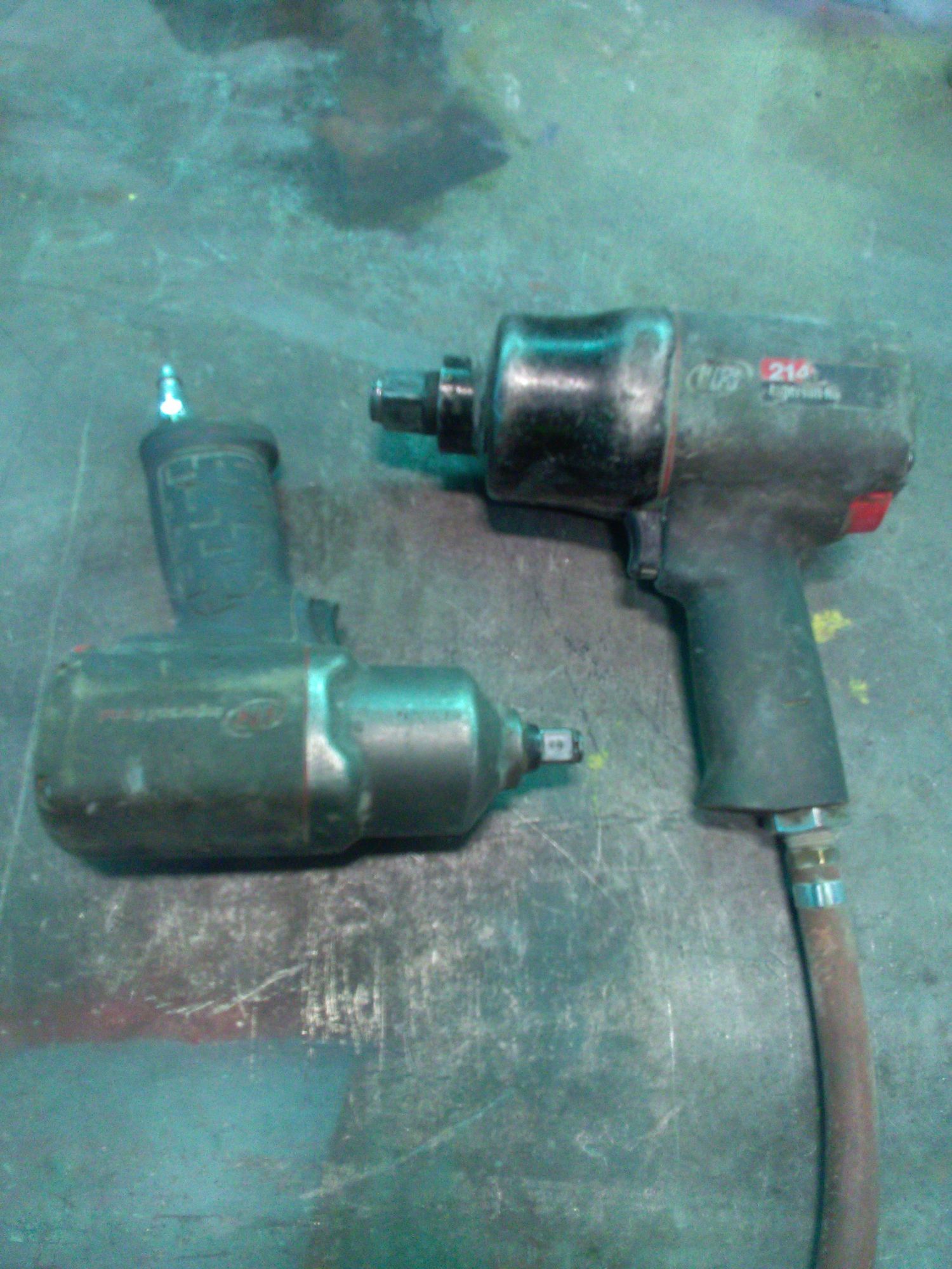

If its on the front wheel pop your tie rod end or ball joint off so you can get your impact gun in there. Air is better than electric as far as an impact gun is concerned, if that is an option. A breaker bar with a cheater pipe will definitely get it off but that does come with the risk of sheering the bolt. Hitting the head of the bolt with a hammer will help break it loose but if you cant get your impact in there then I doubt you'd be able to swing a hammer in there either. I have an IR 2100G impact gun, among others), and while its only rated at 550 lb/ft I very very rarely find a bolt it wont remove. I have actually broken wheel studs while REMOVING nuts that people have cross threaded! As far as heat is concerned, make sure your heating the knuckle and caliper bracket. Try to keep the heat away from the bolt. You want the metal the bolt is stuck in to expand not the bolt itself.

I bought a Dewalt DCF899 not too long ago to tackle a dreaded crankshuft nut on my Volvo S80. I already had a impact wrench on battery, but it lacked the power and I sorta lost confidence in them. But this review did it for me
I have the 20v Dewalt 1/2" cordless and a 18v Milwaukee 3/4" and neither one compare to my 1/2" and 3/4" Ingersoll Rand air impact guns. They battery guns are also very big and heavy. But they are crazy handy if you don't have an air compressor and have the room to use them! As was mentioned before though with air tools a sufficient air supply is critical. For most DIYers a battery (or corded) impact makes more sense.
And I also misspoke in my earlier message (I went to see what models I have lol) My 1/2" is the titanium composite 2135 rated at 780 ft/lb, and the 3/4" is the 2100 series (2141?) rated at 1000 ft/lb. My problem with batteries is I kill them too fast. With a good air supply I can pound on something til it breaks or comes off lol. I also recently got the 20v Dewalt DCF887. THAT THING IS A BEAST!!! The only problem I have with it is its so strong it regularly snaps my socket adapters
