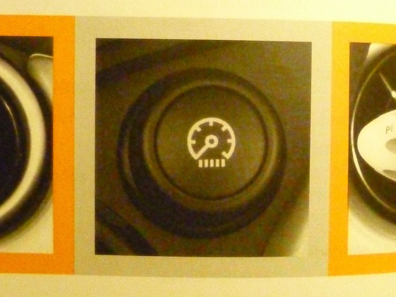

I could use some help, I recently bought a low milage R53.The car is mechanically strong and has a good body but I have an issue. The car has no interior lights, so when the headlights are on the lamps work (outside) but no indicators inside the cabin. Also the blinker indicators or "clicker" is silent but the blinkers and 4-ways work.. I'm assuming I need the dealer to tell me to replace a module somewhere? Any Ideas?

Did you try adjusting the DIMMER switch? It looks like this.
It is a PUSH button each push toggle the switch and will operate the lights in a cycle (dim, dimmer, dimmest, brightest, bright, dim, dimmer, dimmest, etc)

or just push that button & hold it in to see if the dash lights come back up
