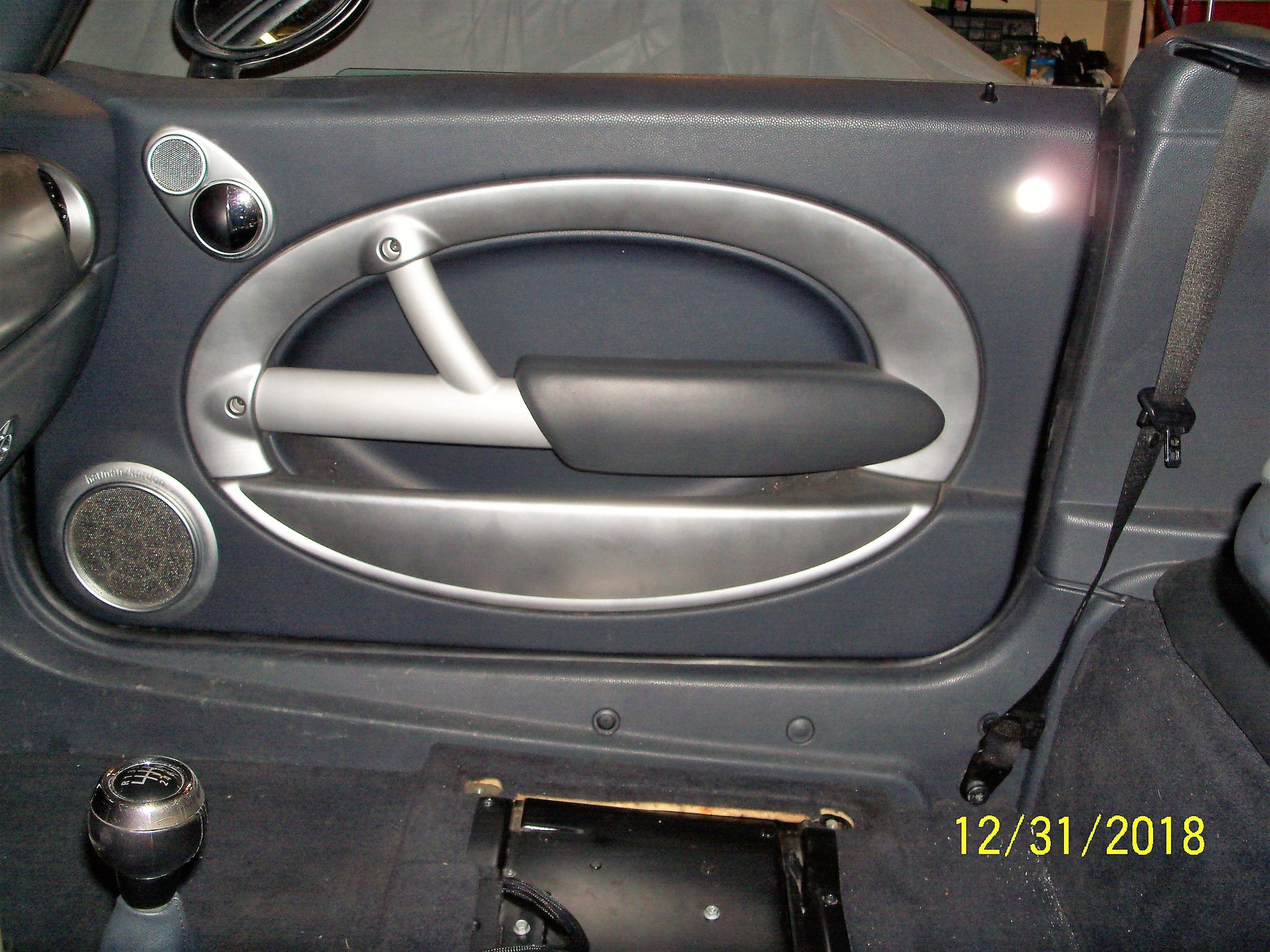

I have a pair of MINI's......a 2004 R53 (mfg 10-7-2003).......and a 2006 R52 JCW (mfg 9-13-2006)
I noticed that the door arm rest pads are different lengths.....is this normal, or did someone switch door pads or door cards? Can I put the longer style on the older car without too much trouble?
First pic is 2004 R53 car, second pic is 2006 R52 car
Bryan

The longer pads are normal for the facelift MINI’s. I don’t think you can switch pads as the way they attach is different, but you should be able to switch the entire door panels. Since you have both I would try it before buying a FL set.
