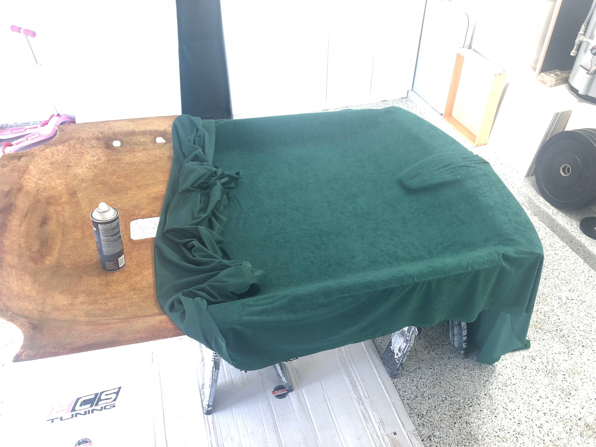

Ok, lets try another update with pics....
As with so many Minis, the headliner had gone to hell in this car, so it was time to pull it, recover it, and put it back. I decided that since the car was green/black roof on the outside, the interior would be black/green headliner. LOL.
Anyway, pics..

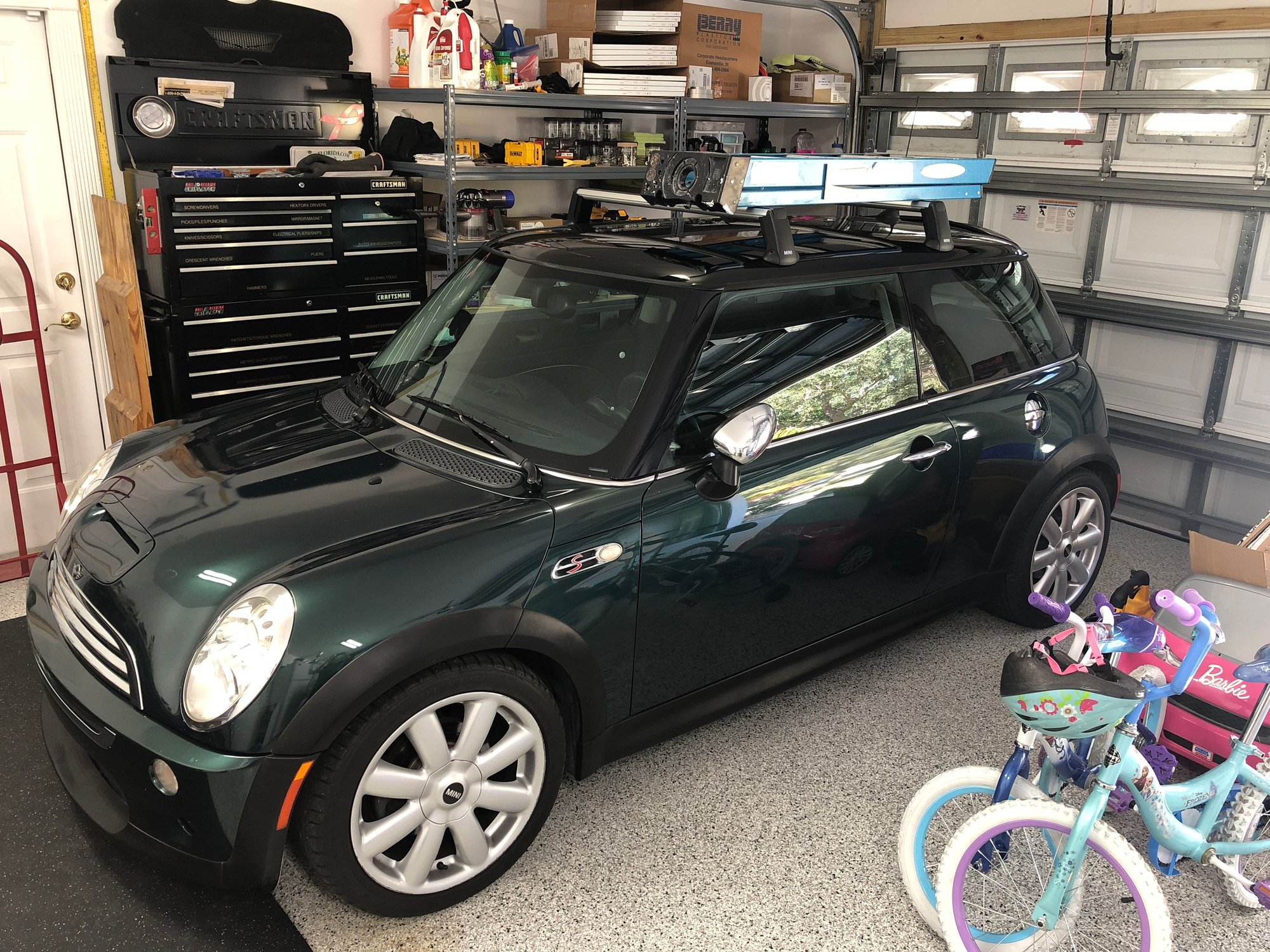

Ok, pics seem to be working for me again! Awesome! Anyway, next update before I completely reinstalled the headliner was to install the OEM roof rack... The sole purpose for the Mini was for me to use as my runaround car, and assist with a lot of handyman jobs I do for people when I'm on vacation from my real job. Yes, I wanted the rack for ladders, wood, etc etc... I didn't know at the time, but my car wasn't pre-drilled, so I had to use the paper templates and make the holes myself. Holy hell this will mess with your nerves, even on a car such as mine with a pretty rough exterior.... Anyway, I used the OEM templates and measured everything no less than a thousand times before drilling. Luckily I started very small and very slowly went larger and larger until I could see the threads, and then I adjusted my holes to line up perfectly. Everything worked out perfectly and the install was a breeze.
Pics below...

With the headliner out, couldn't you have drilled small pilot holes from within the cabin, through the captive nuts?

Hah, I thought about that, trust me! That's why I waited to do both jobs together. However, those nuts are not accessible from the inside, the roof supports cover them from the inside. No other way but to measure and drill from the top.
