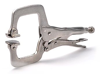

I see the grooves now upon closer inspection. I should have looked more carefully when I started. I did not put any oil on them so that might be why I'm struggling. I will be back my car on Saturday and will try to pull the grommets out by hand. If they come out, clearly they were not set. If they don't come out by hand, I will try to pry them a bit without destroying them. If I cannot get them out by hand or a light tool, I will have to destroy them to in order to remove. Is it better to remove/destroy and ensure they are properly in place or assume they are set because I cannot remove them?
If I cannot get them out, I also might try to use a locking c clamp (picture attached) to fully press them in. Or find something else I can hammer on.

Should not need a tool or clamp as they might place enough pressure to break the plastic. Rubber with a little oil should be flexible enough to push in by hand. I
