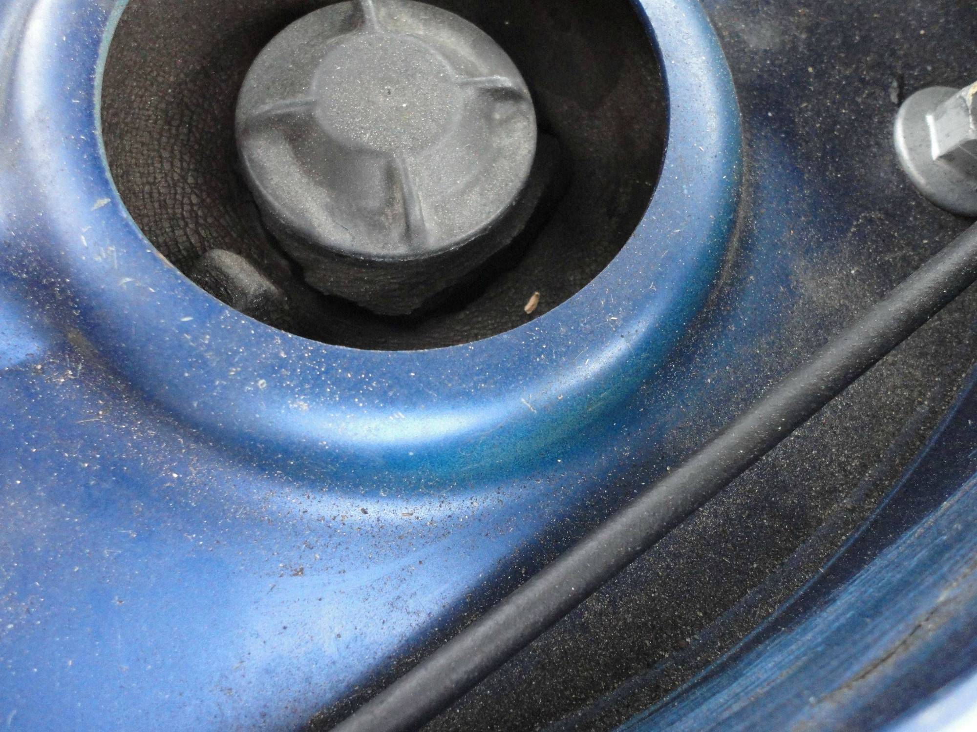

Originally Posted by RUPNOK
Finally had a chance to do the compression test and get the car in the air. Here is a pic of the plugs from cylinders 1-4 from left to right:
My crappy Harbor Freight compression tester read 120 across all cylinders. Take that for what it is worth. Car drives great, so I think that number is low by at least 10-15 psi.
Also noticed that the passenger's side strut bushing has failed as compared to the driver's side:
I was only 50% right when it can to the oil leaks. Turns out the the oil filter housing gasket was leaking, but the other was coming from the driver's side outer cv boot. Can't really see a tear, but oil is/was being flung from it all around that side. Have a new cv axle and oil filter housing gasket coming in the mail. Still trying to decide what to do with the suspension. Should I replace all strut tops only or do the tops with new struts and old springs vs sportier shocks and springs with a very mild drop. Really don't want to compromise the ride on this car as it will not be seeing any autocrossing etc.
Yep , it has the cracks like mine did. I went with the Lemforder ones
https://www.northamericanmotoring.co...ing-issue.html
