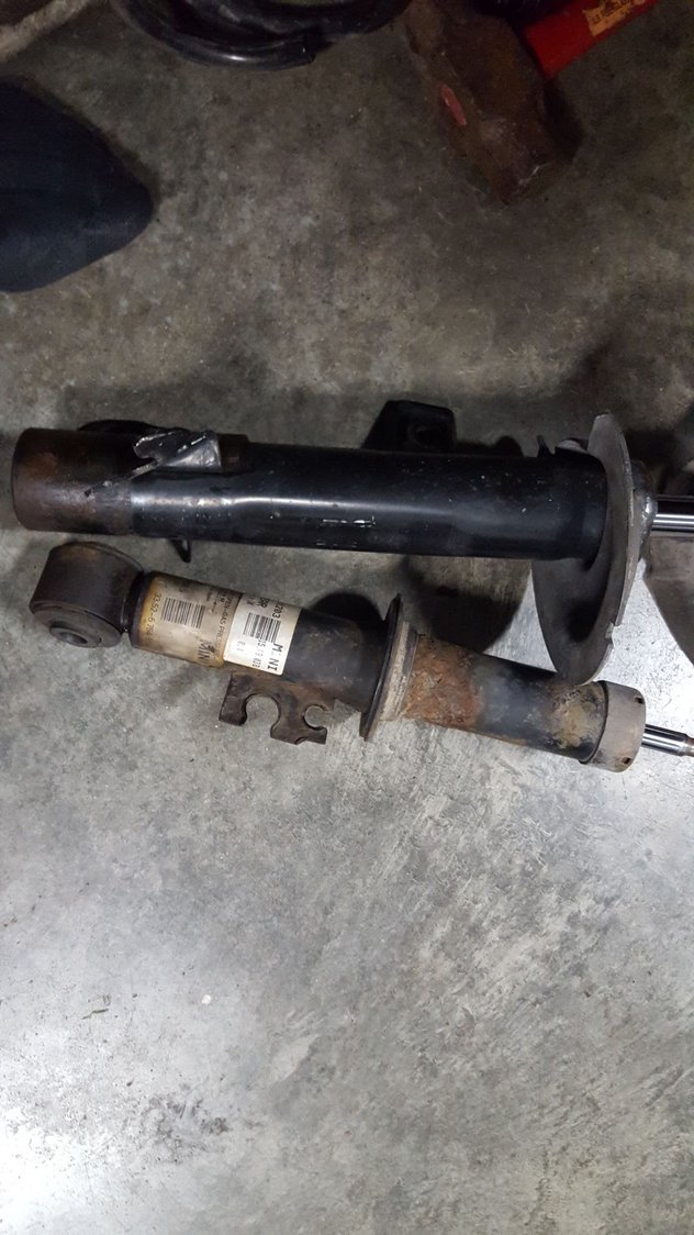

Shocks work both ways and will not necessarily come back to 1/2 way, it depends on the construction and use of the shock. If you go back in posts you will see a video posted by flynbrick showing the strut mount being replaced as well as struts----watch the video and see how much pressure it takes to move the worn strut. That may help you out.

Do you know how many miles are on the shock? Does it have a white tag on the strut facing the tire side?

No idea how many miles.... The fronts have no markings I can find. The rears have tags like you describe.

The rear shock looks OEM, the strut looks like a OEM replacement. Did you get a look at the video?

Yes. It looks like his shocks are a lot easier to compress than mine....

It's time to make a decision, put the strut back in or replace everything. Do you know a Mini owner that had time working on Minis that can help you or take the car to a shop that can help.

Yea, I've decided to change them. The rears are definitely shot and the struts are not smooth when I compress them.
The strut bearings have no damage so, I'll reuse those.
I'm also adding the strut tower plates since they have a small amount of distortion.
Thanks for all the suggestions........

If the struts are not moving smoothly then it is time to change them out.The Bilstein sport shock is a good shock for DD chores.

BTW, the other strut has the big white stickers on it..........

It is probably original.

Yea, no wonder it rides like CRAP.....
