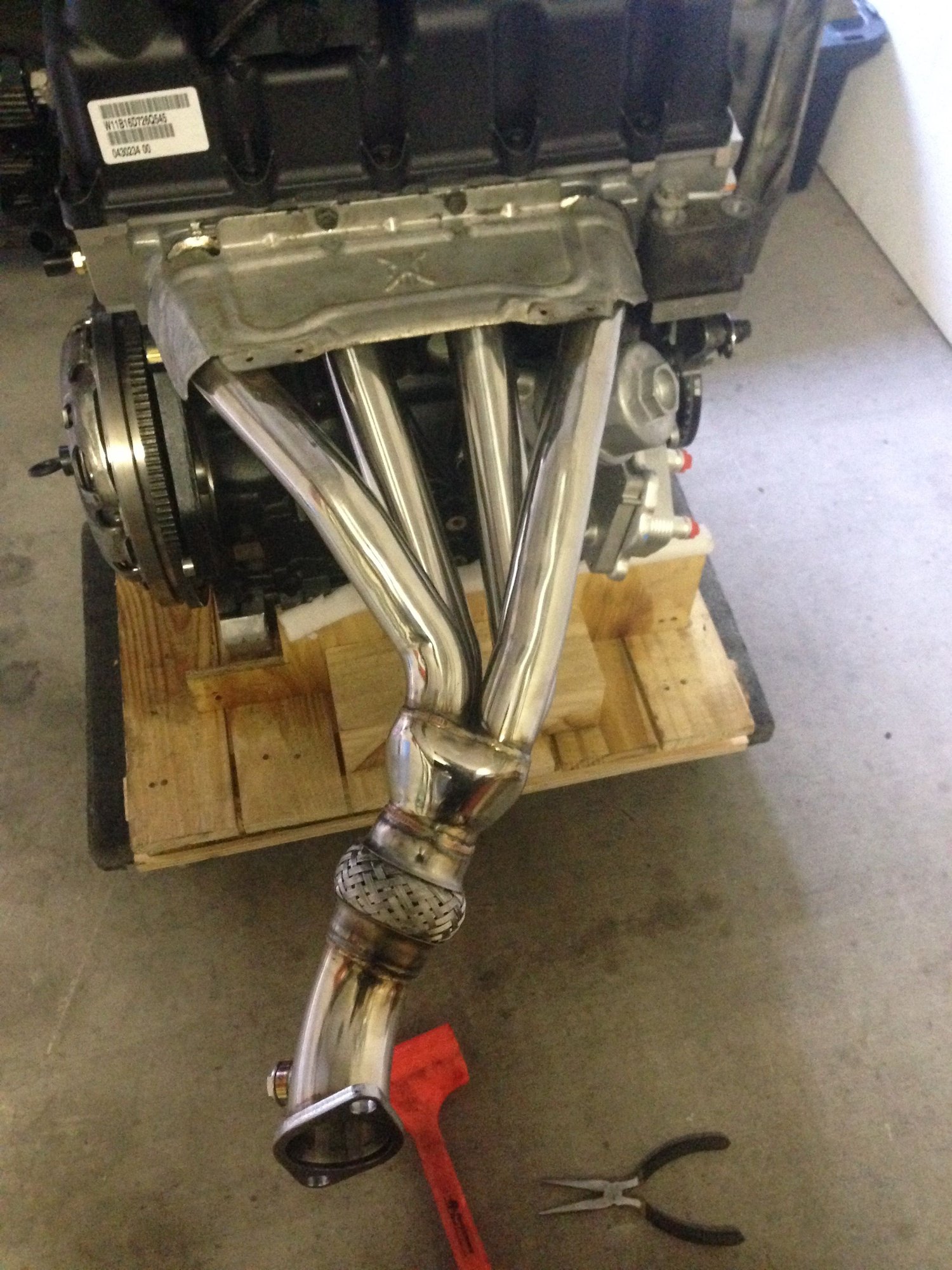

More Progress made today.
Painted the Transmission, and that came out pretty nice. Thanks for planting the seed! Ended up leaving it silver and the motor is black. Also got my header today and tested the fit, modified the heat shield to fit. Also bolted the pressure plate on.

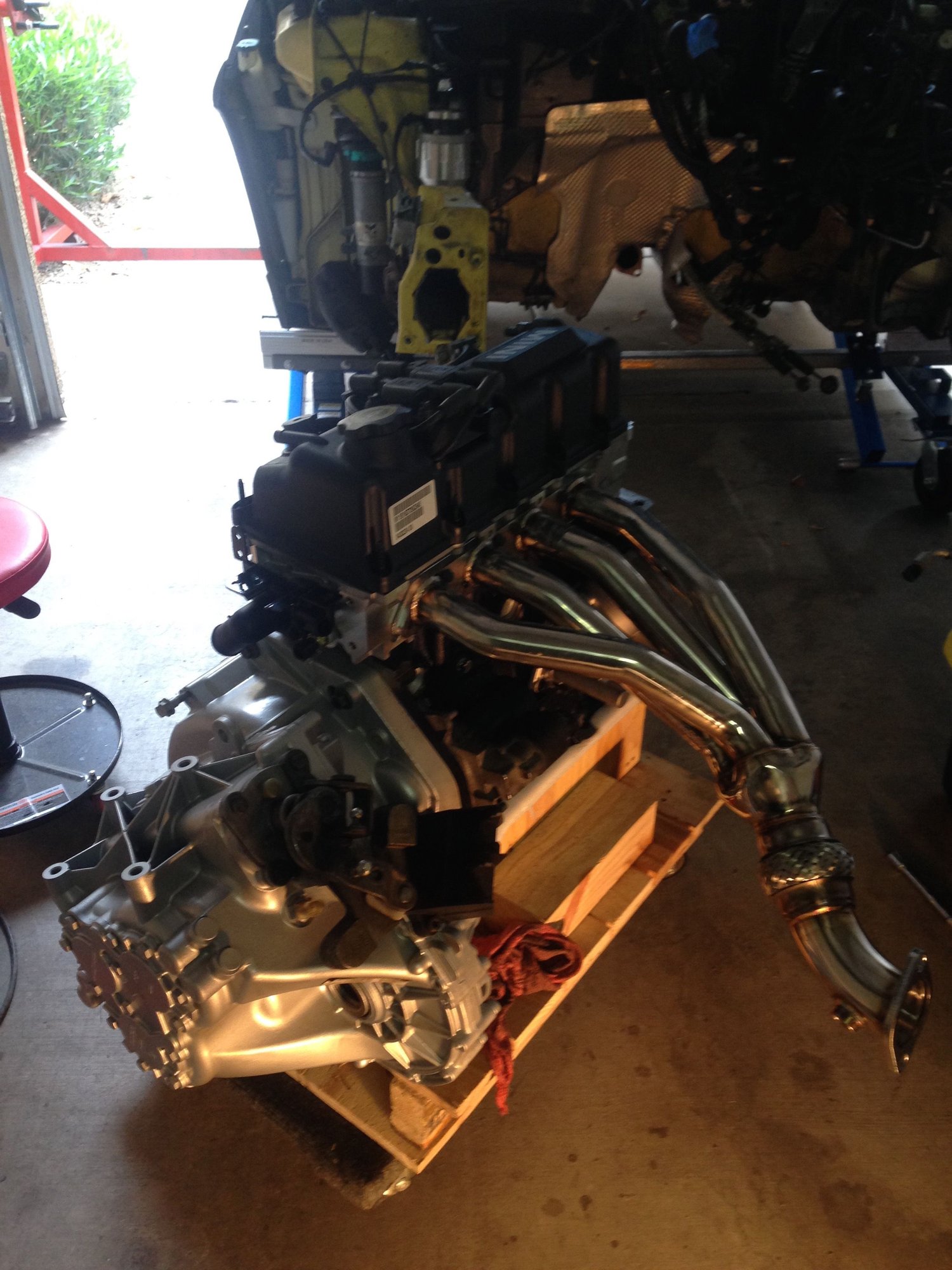

Well, it was a productive day. Got the engine and trans back in the car today. Still have a bit of work tomorrow, but it's coming along very nicely.

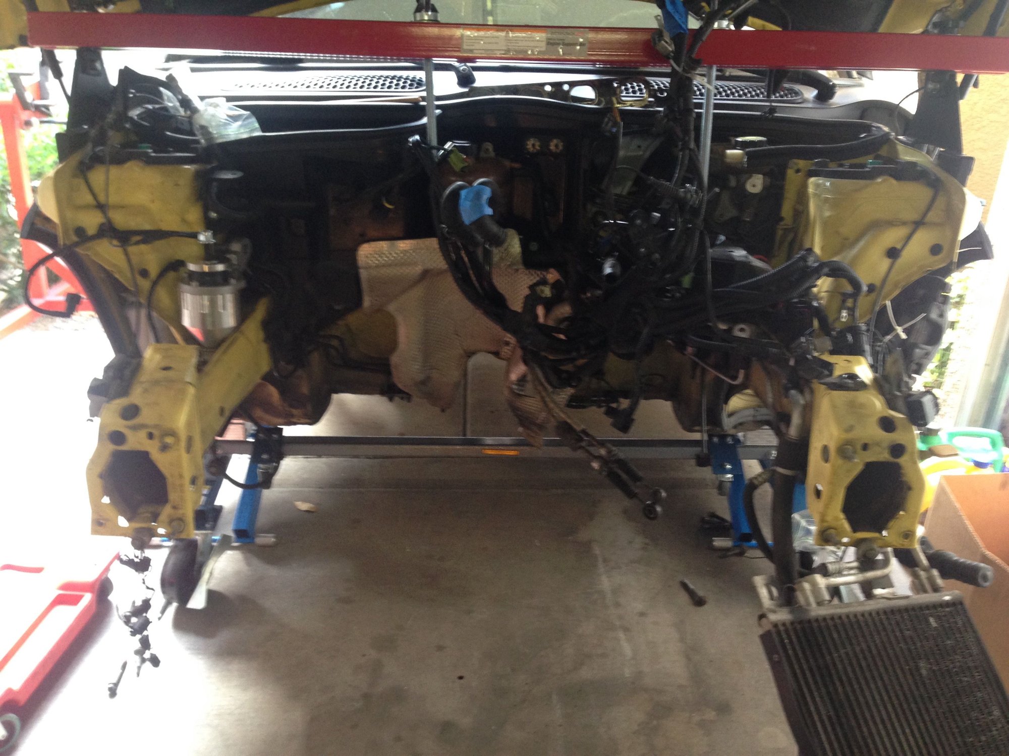

I took the subframe out of the car first, which made it easier to get everything in the car and give me room to work on the back of the motor. Probably would have been easier with an engine hoist, but decided to try it without and use my nice lift...

This is a close up of the subframe before it came out
This is with the subframe out. Very easy to slide out without the engine there. I took the reservoir off the power steering hoses to make it easier to get it back in with the new exhaust. Looked a bit tight. BTW - I changed the hoses last year when I did my control arm bushings and I had the subframe out. It was one of those, while you are in there you might as well do this...
This is a close up after the subframe came out. Nothing in there.....
This is the engine ready to go in... I bolted the exhaust on. Had it tight, but then ended up loosening it back up so the header can hang lower and since the motor sits in at an angle. Since I decided to lower the car down with my lift to pick up the engine by the motor mount, the exhaust kind of got in the way. But, loosening the bolts worked out just fine.
This is the engine and trans almost in. This was pretty close to where it needed to be. I needed to angle the motor back a bit to let me get the motor mount on and get the trans mount lined up. Took a little bit of time, but overall it was pretty easy.

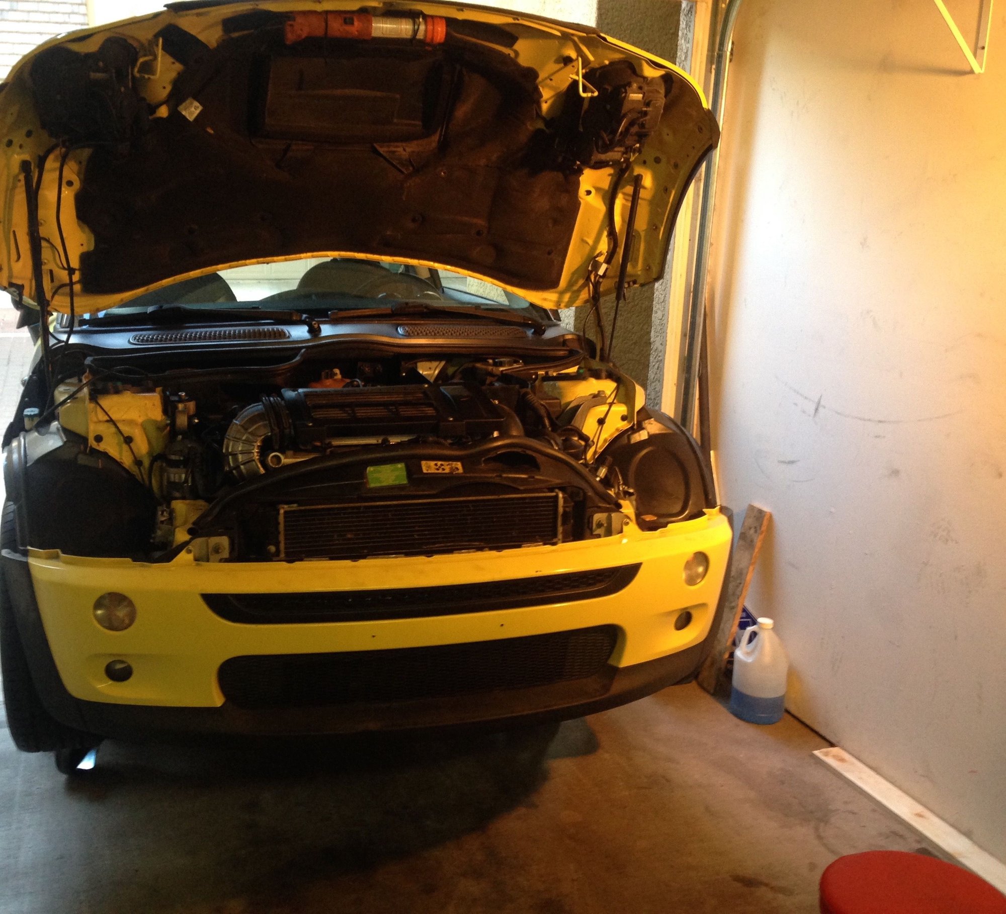

Some more pics.
Here's where I left it last night.
Ready to move it back into the garage.. The bags of parts were dwindling down.
Wheels on, sitting waiting to mess with the exhaust
