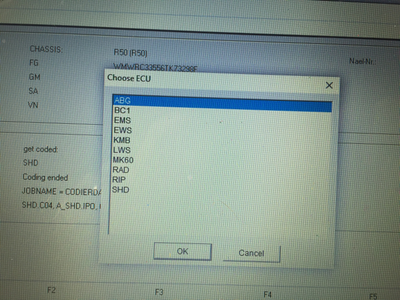

Finally have NCS Expert working. Problem is I am trying to code out bulb checks. I believe this is in the FRM module. But I don't have that listed. Modules I have are in pic below.
Am I looking in the wrong spot for this?

Got it to work. Light checks are in BC1. I was looking for an R56 module.
Anyway, finally got it to work and my LED bulbs are no longer putting on a strobe light show when I turn the key.
