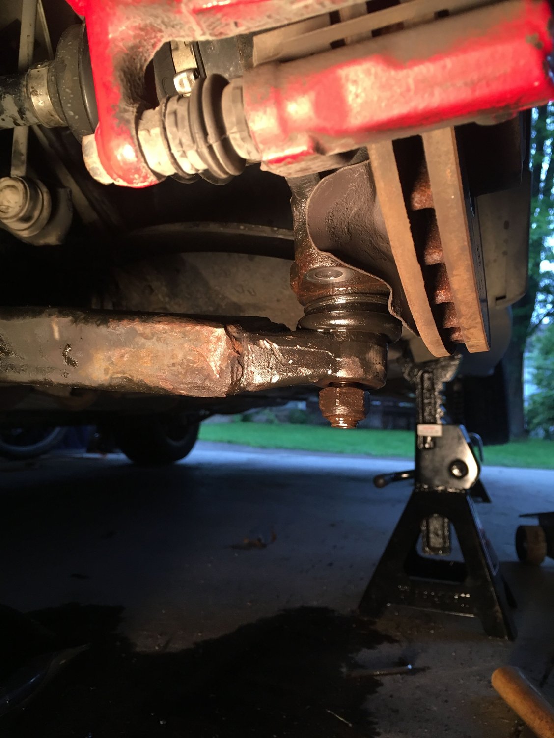

I need more help. I cannot get the lower a-arm to separate. I've whacked it from every angle possible, tried a pry bar, soaked in WD40. Is there a tool out there I need to be using? I'm feeling defeated after fooling with it for over 2 hours... Lol. I removed the 2 bolts holding it, and also the lower nut (put back on to protect threads)

Get a decent Ball joint separator and more effective penetrating oil. I use Kroil oil (buy it from Amazon).

Local parts stores usually have one to rent for free. Good tool to have in your tool box though
Sometimes you get lucky and they pop off using a hammer but usually not

A ball joint separator. I'll check the auto stores tomorrow. I noticed the rubber boot has a hole in it, so I'll plan on replacing it if I ever get it off. Haha.

If I remember correctly the easiest way to do it is pull the brake caliper and disc off (and maybe the wheel bearing too) then I used a long screw driver to lever against the top of the ball joint to push it out of the steering knuckle. I like pb blaster for penetrating oil but it might just be superstition that makes me think it works better than wd40.
i would smear some antiseize between the ball joint and the steering knuckle when you put it back together. It'll make your life easier if you ever have to take it apart again.

I bought a ball joint separator and successfully separated the ball joint from the lower A-arm. The ball joint itself is still seized up above. With the two bolts removed, the ball joint should come right out, right? I had planned on replacing the ball joint since the rubber bushing is torn and the joint separator wasn't the kindest...
With the lower A-arm out of the way, the half axle came right out with the inner boot removed. I left the knuckle piece in the transmission and didn't see how that actually comes out - force it out, a clip, ?.

Yeah the axle is held in with a clip. Use a pry bar or a thick screwdriver to pop it out.
Since the ball joint is already wrecked, spray it with your anti rust stuff and pound on it until it comes off.

Essentially yes - mine still took a little hammering, it sits in a tapered ring that can get pretty rusted. You can get to the top of the taper from the inside of the knuckle to blast it with lube if you haven't already. A sharp whack should shock it loose.
