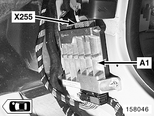

So, something of a major development today. I've noticed a sloshing noise from the dashboard area very infrequently since buying the car in 2015. Never knew what it was and it happened rarely enough that I didn't worry too much. In the last year or so, I've noticed (again, very rarely) some water come out of the front of the headliner and more recently pool straight on the floor from the A pillar. Finally pulled the headliner down a little to check the sunroof drain hose. It was connected. Checked the drain port itself and found it to be blocked at the top. Cleared that and dumped water on it and it cycled through no problem. I took out the rubber floor mat (that I put in very soon after buying the car) and vacuumed the water from the front of the carpet and was about to button everything up when I noticed my elbow was soaked from where I had it resting on the carpet. Pushed my hand down at the rear where it slopes into the seat and water shot through. Felt around at the front of the carpet and while I couldn't get any water to come through - in fact, it felt dry - I could hear literal sloshing from underneath. So I took the seat and kick panel out to pull the carpet partway up. The entire floor pan was flooded. The wiring harness was literally submerged. The carpet has a couple inches of foam padding underneath most of it, which is obviously thoroughly soaked. Considering I remember hearing sloshing when I bought the car, it's probably been like this for many years. All because of a teaspoon of sediment on the passenger sunroof drain port. I never noticed because there's no smell and I've always had the rubber floor mats so no water would come through when there was weight on the passenger floor. So I guess I'll spend tomorrow with a bunch of towels trying to sop it up without taking all the center console bits out.
I seem to remember reading awhile back that airbag codes have to be taken to the dealer to be cleared. I don't really want to put the seat back in just to hook that up. I have INPA on my laptop so surely that can clear the code given its the actual BMW diagnostic software, right?

It appears my BC1 is fried now that the harness is no longer fully submerged in water. How wonderful. Several exterior lights are now on all the time, hatch lock won't respond, high beams don't work, dash lights don't come on etc. How can it be that now that the water is purged from the wiring that it decides to get destroyed? Guess I'll just have to disconnect the battery every time I get out of the car and hope that no one gets confused from my lights. Super.

Anyone know what this grounds? I'm hoping this is my only problem. I don't see how I could have broken it when taking the carpet up and I didn't see any sheared wires anywhere. I looked back at my previous photos and it was missing yesterday. Maybe the water was causing it to still ground? I really don't know.

Well I either have at least 2 problems or the BC1 is indeed fried. I must have at least one short since the left side turn signals and rear fogs remain on all the time and I must also have at least one open since the electric hatch lock, high beams, dash lights, and windows don't work. There are probably more problems but I haven't driven the car yet. Really not sure what to do. Can't find where those elements would share a common ground. The ground I found that was broken in the previous post may not even be stock. I found pictures of the BC1 that includes that member that should have the ground on it and it's not there.
It would be in the lower left in both pictures where the metal raises.

There's another harness on the opposite side of the car that is probably also wet I would use electrical cleaner on all of those connectors unhook them clean them re-look them make sure there's no corrosion on the connectors

The other side of the car is dry. I think all of this water stemmed from the blocked sunroof drain on the passenger side.

Tried accessing the BC1 with INPA. It doesn't report. Say it is toast. Is it even possible to program a used one to the car with ISTA? Obviously if my problems persist, it's going to have to be dealt with sooner than later. I couldn't figure out how to try and update it back when I wanted to code out bulb checks.
