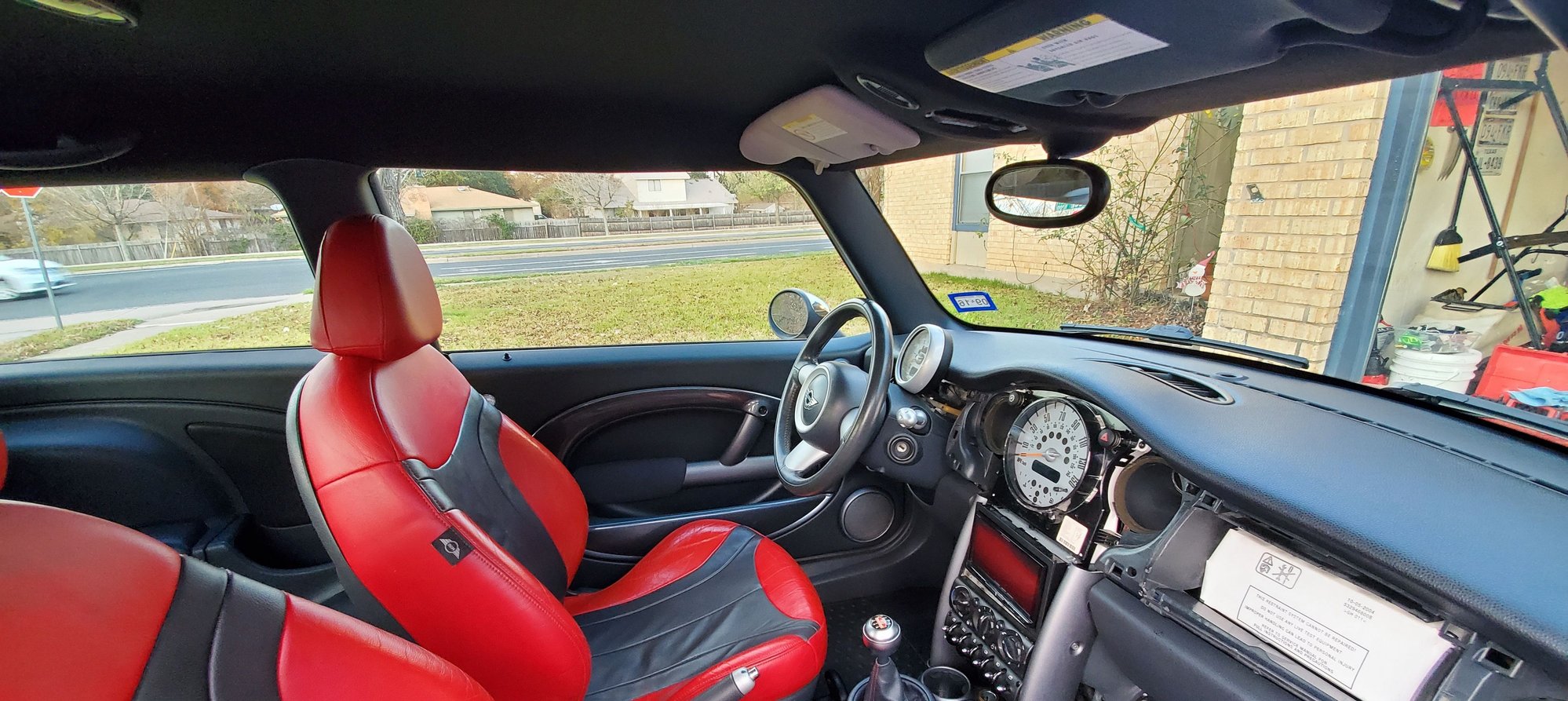

Well, I'd like to thank @bump32 for inadvertently embarrassing me and the way my Mini looked. I hate to admit it, but the entire time I've owned the car (and it seems the entire time my mom did too) the MC40 has never been washed. I was staring down what looked like 10+ years worth of grime and dirt. On top of that, she used to call it the Whippet Mobile because she would go to all of her dog shows in it. Did she put a blanket down? Any type of covering? You bet she didn't - not one time. The amount of dog hair was... insane. Seriously.
I was also going to wait until it was completely done but I won't have the bumper/hood fixed for a while and I'm still waiting for the C4 black trim restorer to come in.
Honestly, when I first went into this it was because my ebrake boot was torn off and I wanted to replace it. I ordered a new one online but thought to myself, why don't I make the trim around it look good too? So I tore it up and you wouldn't believe what I found:
While working on this, of course my roofliner started coming off so had to do that too.
Anyways, as I got closer and closer to finishing the roof liner, the next thought passed in my mind: why would I put a new piece of cloth into that forsaken Mini? If the emergency boot looked like that, how bad was the rest of it? I decided I would start with the back carpet and go from there.
DOG HAIR EVERYWHERE. I originally thought the seats were supposed to be grey/white: NOPE. That's DOG HAIR. I figured I'd remove the carpet and work on it in a sealed off hazmat chamber. Let's take a quick look at the rest of the car.
Alright. Well, if I'm going to clean this and have it look anywhere close to as good as bump32's then I need to do it right. Time to start removing ****!
Oh. My. God. That carpet. Why's there no throw-up emoji?!?
Fine! Let's do this!!!
I took every piece off and decided I'd clean them one by one, reinstall them again one by one and just take my time making sure I do this right. This car is my pride and joy. I've basically replaced all of the engine components, interior components, and just bought all new springs, struts and camber plates. Why the hell would I not want it to look as good as it can?
Carpets first! The water looked like cola when I was done.
I won't bore anyone with the minutia of the rest of the details but it was a LOT and took me about two weeks to do. This whole experiment has made me realize that I am also WAY out of shape. My hands have been hurting non-stop for the past week from all the scrubbing. I cleaned every interior trim piece with Orange Cleaner and then put on two to three coats of Black Wow for each piece. I also dropped the front seats off to get re-dyed since they looked like poo.
In the end, I think the juice was absolutely worth the squeeze, even though I won't be able to squeeze anything for a while now lol. My brother also used to be a professional detailed and came over and polished the car for me. One of the best parts of this whole scenario too was all of my neighbors coming up and asking questions and talking about how they've noticed the difference in the car. One of my neighbors across the street started working on his old truck that was sitting in his garage; a friend of mine also bought an old 96' Ford to work on because he was inspired by what I was doing as well.

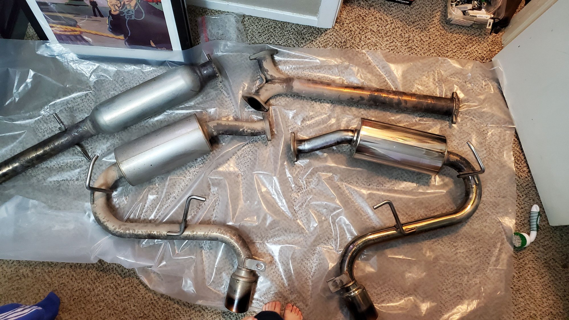

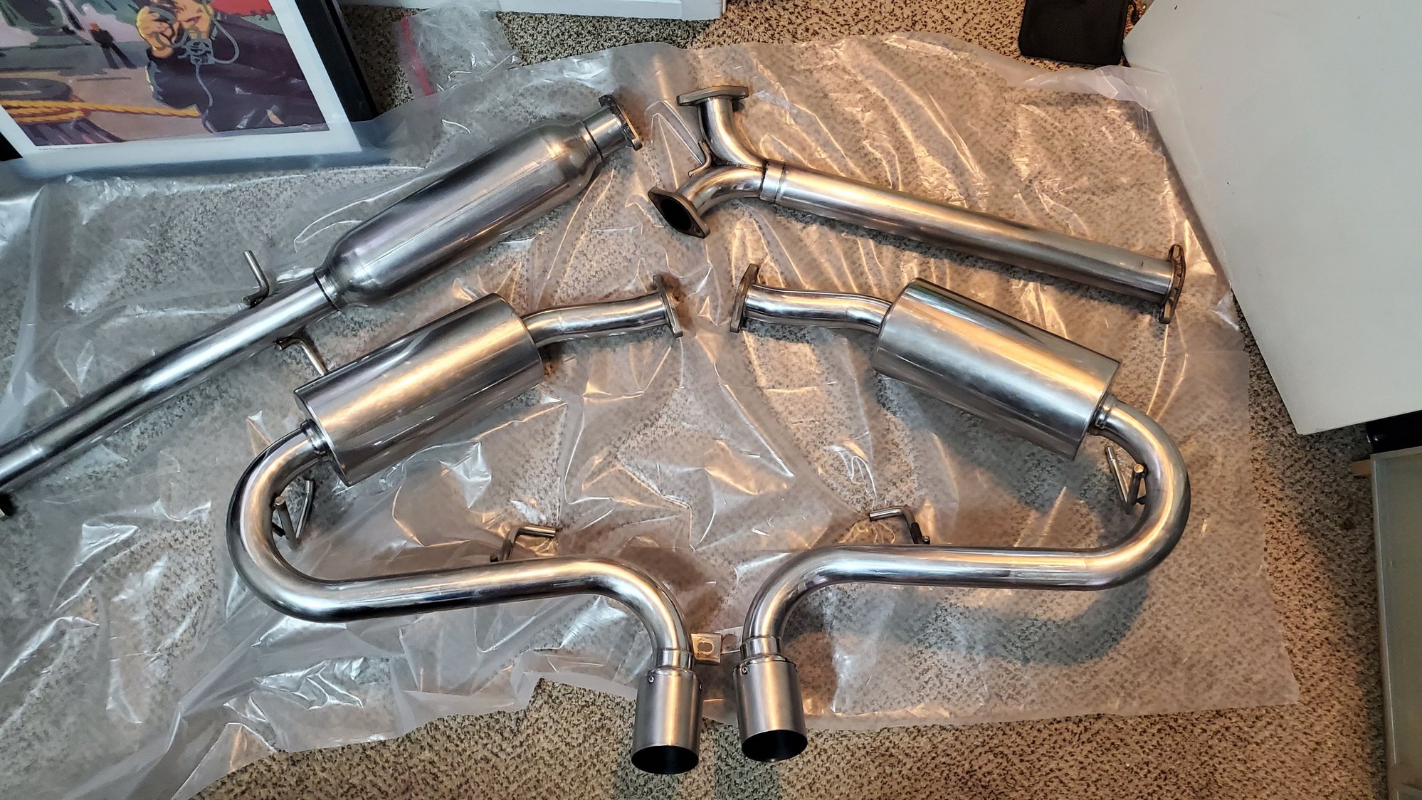

After I got what I was looking for, I had a little bit of time left so I decided to pull the exhaust off to see if I could identify it. I saw a tiny bit of writing, so like an old timey prospector I spit on it, rubbed it hard... and found gold!
Looks to be a full Invidia catback exhaust! This Mini is an '05 though and after doing a bit of reading I'm not sure if it'll fit my '04 without doing a ziptie/wire hanger mod for the middle hangers; doesn't seem to be a big deal though. I also want to get it good and cleaned up to see what exactly I have as I had already decided my next big purchase would be a Milltek exhaust and this certainly puts a kink in things! In preparation though, I ordered all new gaskets and bolts... just in case .

I also followed-up on my call to Mini about retrofitting the Chrono Pack and got a hold of a tech who seemed to know a bit more. He told me it would be $200 for them to flash the software or whatever it is they do, but it was a 50/50 shot that it was going to work (and of course the money was non refundable). So on a whim, I decided to plug in the tach/speedo. Initially a lower mileage popped up (oil change I believe?) but what appears to be a higher mileage is now on there (I believe I was about 103k). Both the tach and speedo seemed to work just fine. I then went ahead and plugged in the dash and it worked - partially.
The coolant temp and the fuel gauges work but the oil temp and pressure do not. Likewise, the traction control and tire pressure lights were on and wouldn't turn off. I had taken the bumper off, and also reinstalled the back wheel well covers so I'm wondering if I knocked something loose. I put the regular speedo and tach back and the higher mileage still appears to be there. If I can figure out how to get the oil pressure/temp gauges to start working that would be killer, or, if since the rest of it works, maybe I have a better than 50/50 shot to get Mini to flash it and fix it. It seems like I have to get them to do it now anyways to correct the mileage.
Use NCSDummy there you can easier see which codings are possible.
Also VIN with NCS. Or Tool32.
Than you get it work.

This shows the battery power (which only worked infrequently) and the oil pressure (though that never worked). Could that mean that the ECU is already programmed for the oil gauges, or maybe I could reroute the wiring from the gauges to the chrono dash?
On a side note, I plugged the original tach/speedo in this morning to drive to work. As soon as I started it up the correct mileage appeared (I was correct about it being around ~103k), though the TPMS/traction control lights were still on. After I started driving it though they went off. Could the chrono kit be storing the old Mini information in it? Maybe still configured for the other tires? I did the reset thing (put in 2nd ignition position, hold sensor below e-brake for 30-seconds) but didn't drive it around afterwards with the chrono on it.

In the meantime though, I wanted to figure out what I had in this Invidia exhaust. I reached out to them repeatedly to see what the best way to restore it was and didn't get a single response back. I didn't see a sticker on their site either and inquired about that as well... nothing. I guess they're busy and/or don't care about salvage pieces. Oh well. I turned to trusty ole' Google and decided to give it a go myself.
This is what they looked like before (the muffler on the right I had already started cleaning a little... also, those are my little man's feet in the picture, not mine lol):
I found a guide that said start with 220 grit sandpaper and work your way up. I did a 220, 600, 1000, 2000, and 3000 on each piece.
I thought the titanium tips looked rather dull compared to the stainless steel on the rest of the exhaust so I blowtorched them to get the blue back. The one on the left doesn't look quite as good because I need to polish it still but I think they turned out pretty good.
I know there's some debate as to the "ricy-ness" of blue tips but we'll see how it looks when I get it installed this weekend. My wife was also didn't understand why I was spending so much time working on something nobody would ever see.
Yeah, got me there. I don't know either.

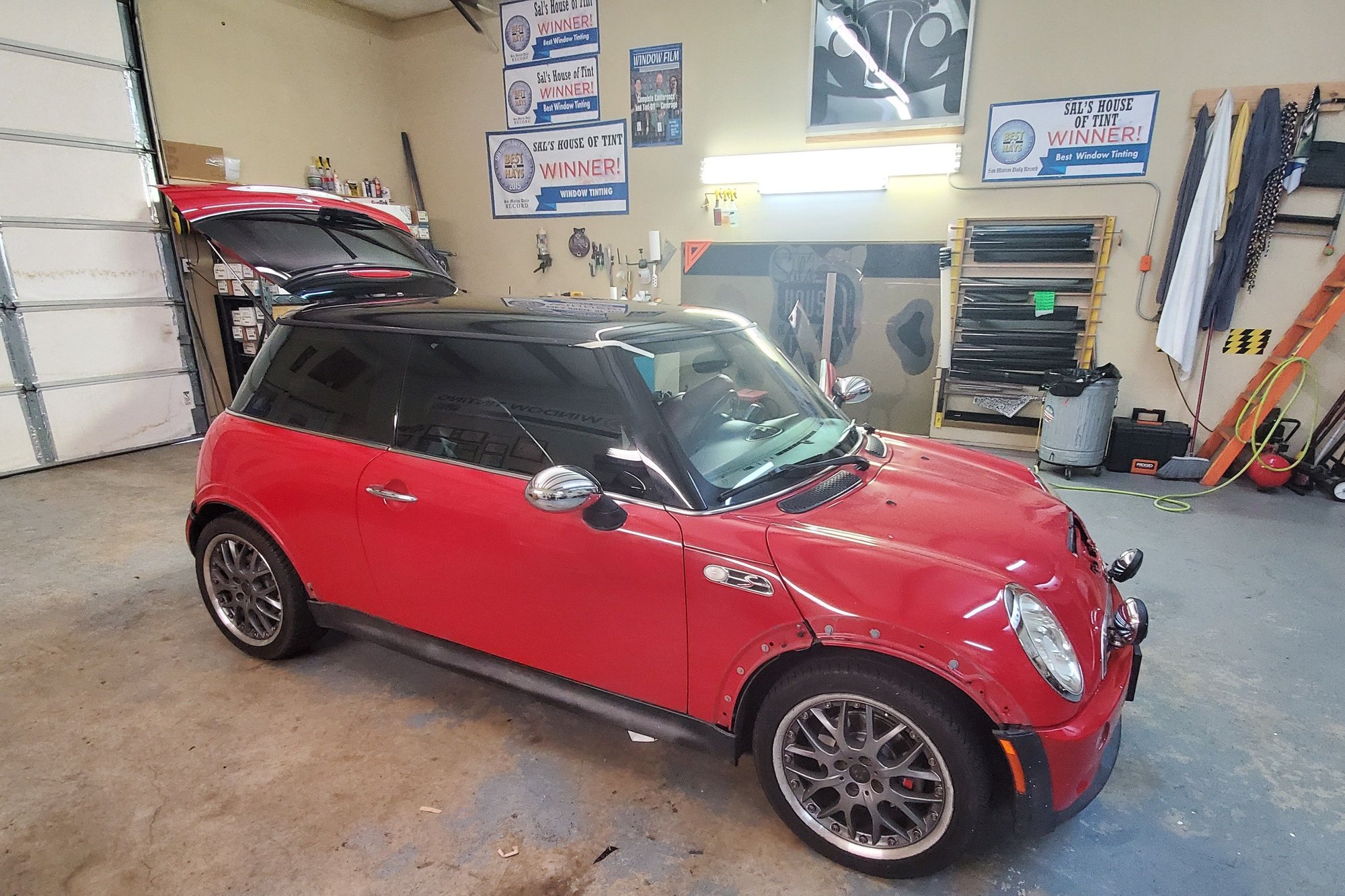

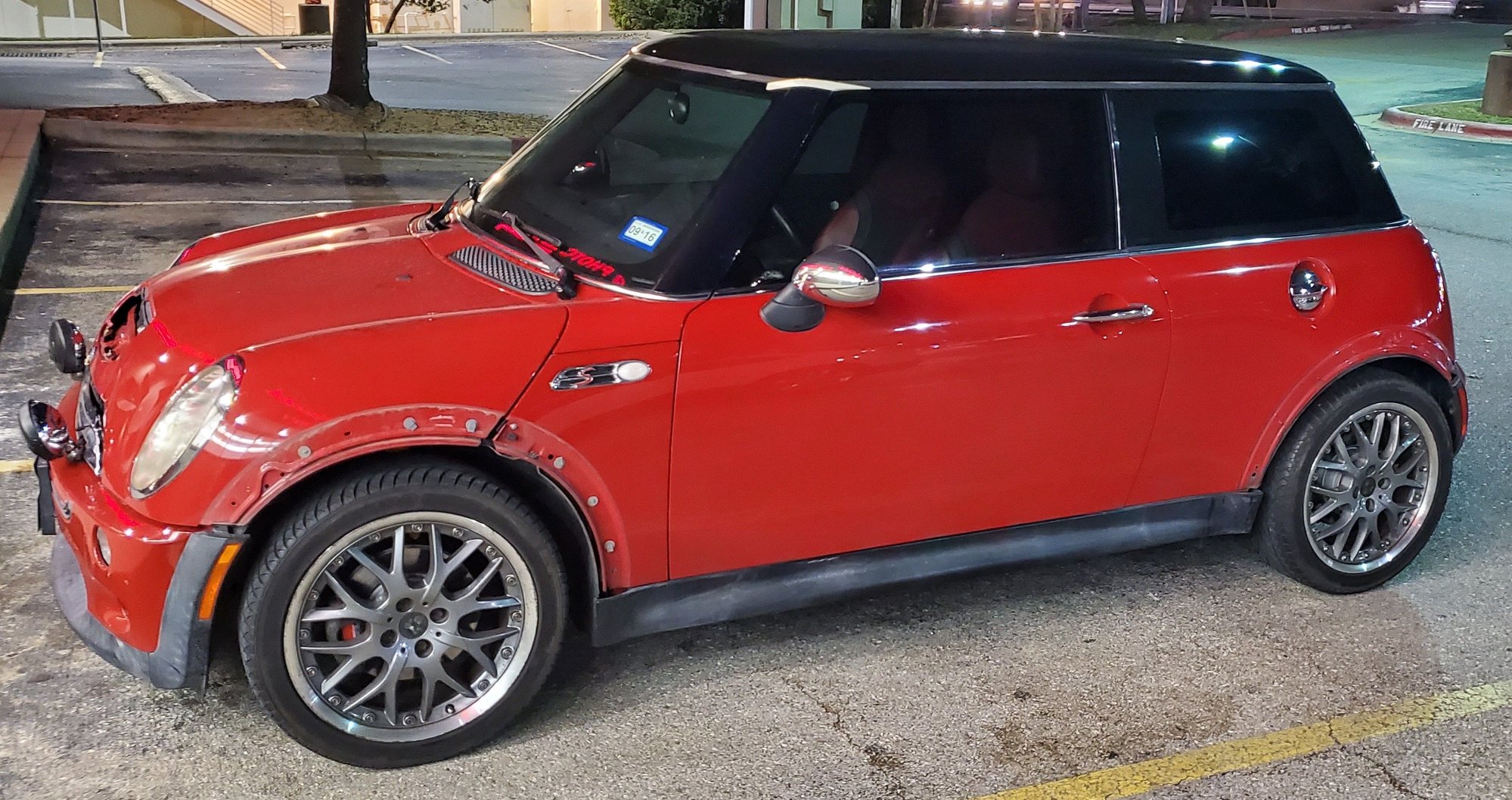

Last up, something I've been wanting to do for a while: tint and roof wrap. I was tired of getting blinded by everyone behind me. I also think tint 100% of the time just makes a car look better. I'm also a big fan of super dark tint in the back with a black roof wrap so it looks like it blends in with itself.
If you ever find yourself in San Marcos, Texas, Sal at Sal's House of Tint is literally one of the best tinters in the world. Not only does he have a ton of local accolades, but in 2017 he won Best Tinter in a worldwide contest. During the summer he has to schedule people 1-2 months out because of the demand for his services - and this is all through word of mouth. I highly recommend him and his wife.
I LOVE how my car came out. It looks brand new to me and it came out exactly how I was hoping it would. I didn't have the spoiler wrapped or attached because I'm talking to someone currently about a GP wing. I also need to buckle down and finish painting/updating the trim so it looks way less hooptie than it does lol.
