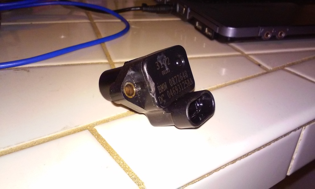

Found it, the line is broken but the sensor is good.

MAP sensor
http://bmwfans.info/parts-catalog/12140872648
Old Dec 16, 2015 | 06:37 AM
graveshaker's Avatar
graveshaker
Joined: Nov 2015
Posts: 74
From: Saginaw, MI
Originally Posted by Mike87
The map sensor is fine, the grey line is what I need.
Old Dec 16, 2015 | 07:51 AM
Mike87's Avatar
Mike87
Joined: Jul 2003
Posts: 272
Likes: 35
From: Hauser, ID

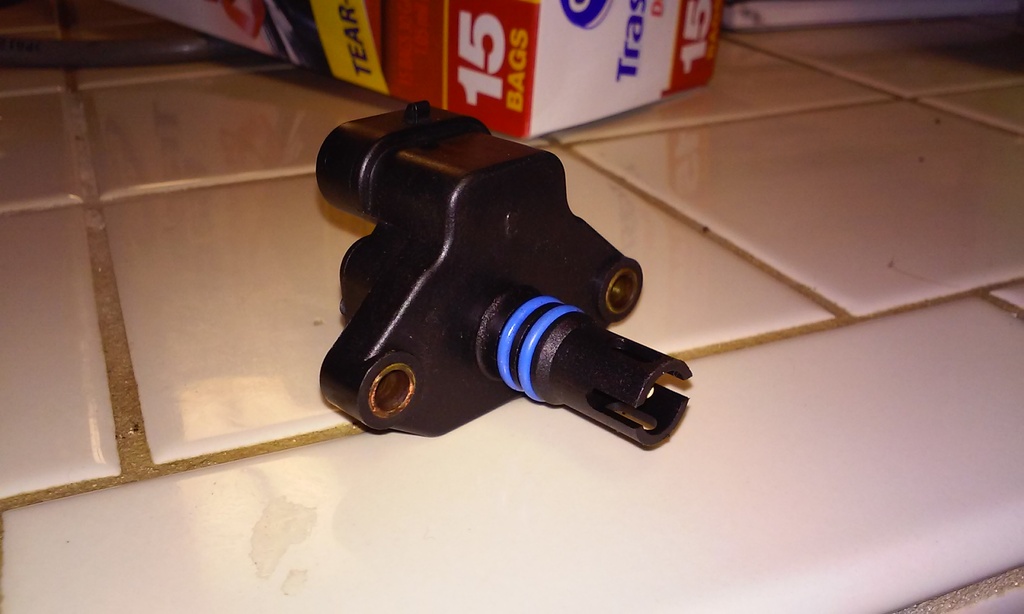

That line does not look broken. It looks like the MAP sensor tube is broken off inside the line. It is like a barb tube. I could be wrong, but that is what I am seeing from the photo you posted. The MAP sensor needs a vacuum signal to work.

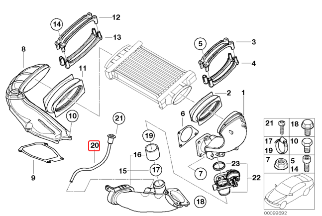

The gray line you're describing should be the tubing for manifold air pressure sensor or the map sensor hose HERE (#20 below). It's common for it to break during installation due to it being worn out. It does look like Mike is right in that the sensor tub is broken off into the line. Looking at your image it may be time to replace both, but maybe see if the black piece on the sensor will slide off, if so you may just needs the hose. The map sensor is at that link as well. Let me know if you have any questions.

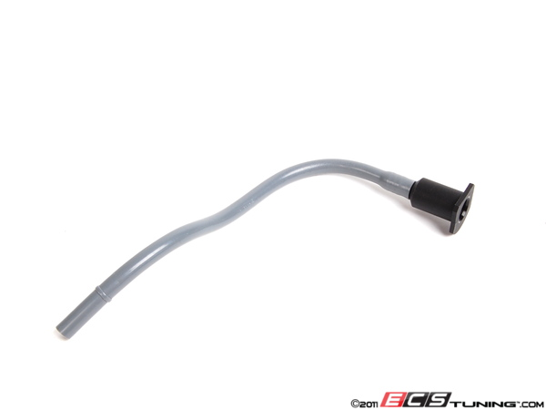

Thank you Pelican, my sensor is fine, the black end of the tube is what broke off. Do you offer next day shipping to Michigan for the grey tube?

This is the part I need
You're welcome. So the part is HERE. If you click that link and add the part to your cart it will bring you to shipping options, which I believe next day shipping is an option. Let me know if you need anything else.

Pressure Sensor Hose For SuperCharged 11651504943
https://www.ecstuning.com/Search/SiteSearch/11651504943/
We are closer and I can work to get it here asap, might be a day or two then it will ship out.
