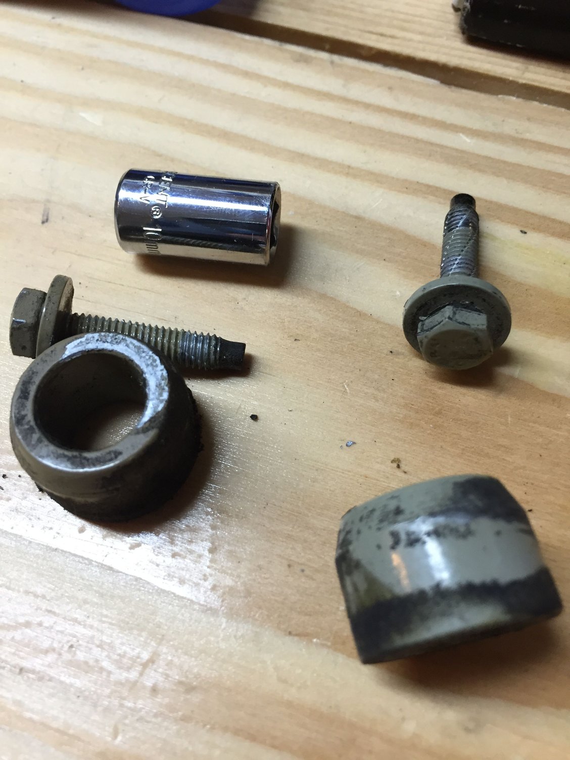

So I recently replaced a few parts on my car (oil pan gasket, cv boot, control arm bushing, upper motor mount and lower motor mount) and ran into a bit of a problem while putting it back together.
I have these two 10mm bolts/screws and their odd washers. I have no idea as to where they go. If anyone knows the location or has ideas or help it would be very appreciated.

Did you put the car in service mode? Those look like they are the bolts and plastic washers that help line up the radiator support and bumper. I didn't remove those when I did the work on my car.
I agree those go on the front of the car - helps line up the metal bumper.

Wertles and kahnfucious you are both correct, that is exactly where they go. Thank you! Jc130chief thank you also.

Alignment screws and washer , correct. Those two are right on point.

When re-installing them, install them finger tight until you align bolt the radiator support and bumper support. Otherwise you'll have a hell of a time getting everything to fit together: basically, you want those bushings to move a little as you install the other bits.
