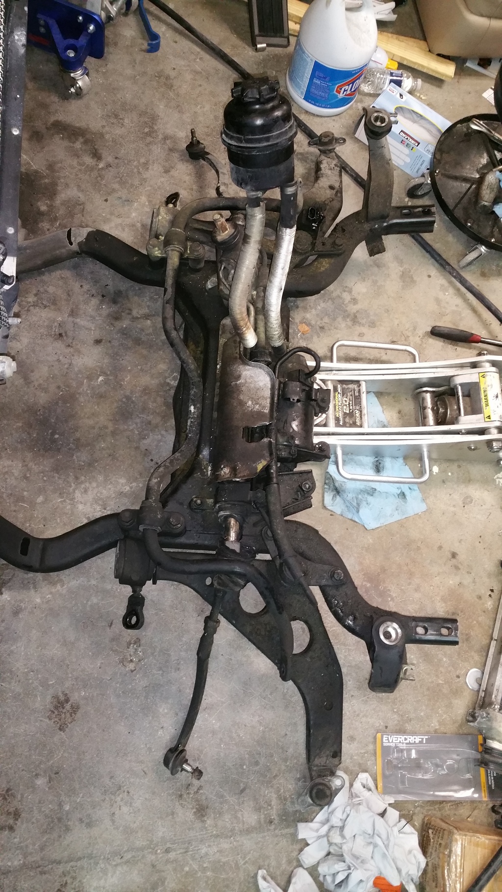

nasty subframe

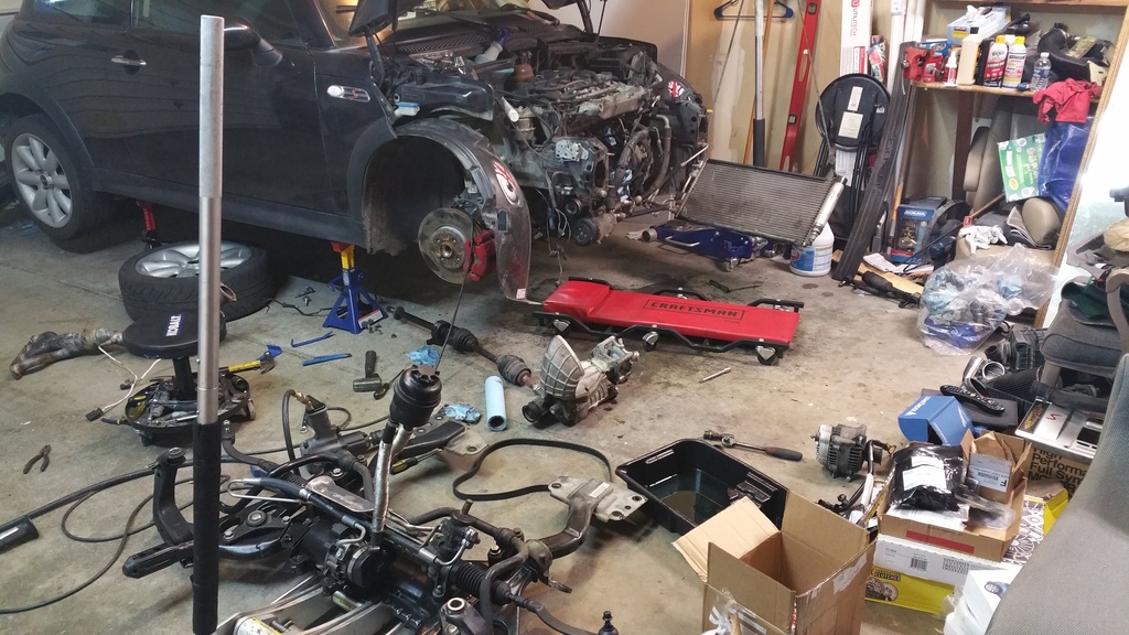

what a mess....

even bigger mess....I have to put all this away every night so my wife can park on the other side....

nasty subframe
what a mess....
