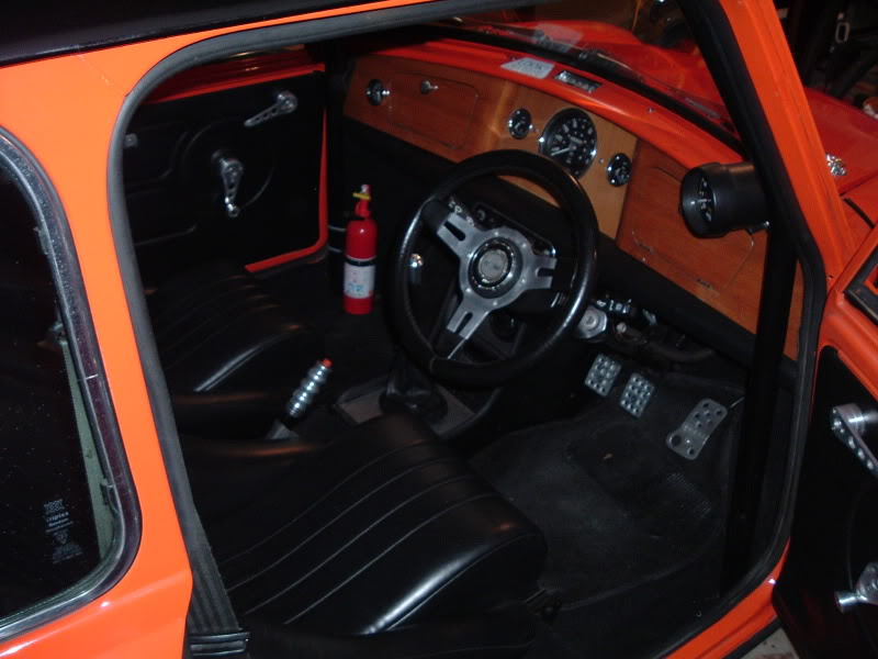

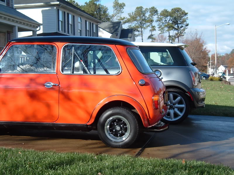

I have a Safety Devices bolt in type in my 79 ..... it fits VERY tight. Strong straps are typically used to squeeze the legs together just to get it IN the car .... the interior was stripped BARE when the install was done.
you can see the bars????
I see they make parts for "MINI" .....

I'd replace that 2.5 POS fire extinguisher with at least a 5 pound. That no gauge design is something of a sick joke.
