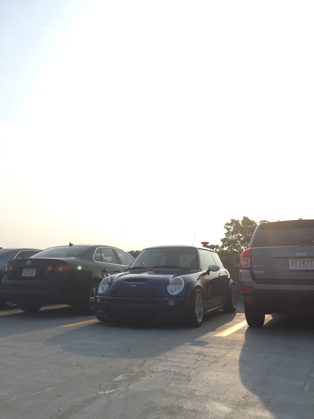

So I haven't driven the car around since I swapped all of the parts in, was having some trouble making it to the RMV to register it during the week. But this morning I finally drove her on the road, took a 3 mile trip to the subway station where I typically hop on the train to go to work..
Everything seems fine, just getting a loud knock from the rear shock tower.. Can't really think of what it is at the moment, I know everything is tight and torqued to spec in the back... I'm thinking worn bushings.. Will need to take the time to check it out as I'm shooting for an AutoX sesh this upcoming Sunday.

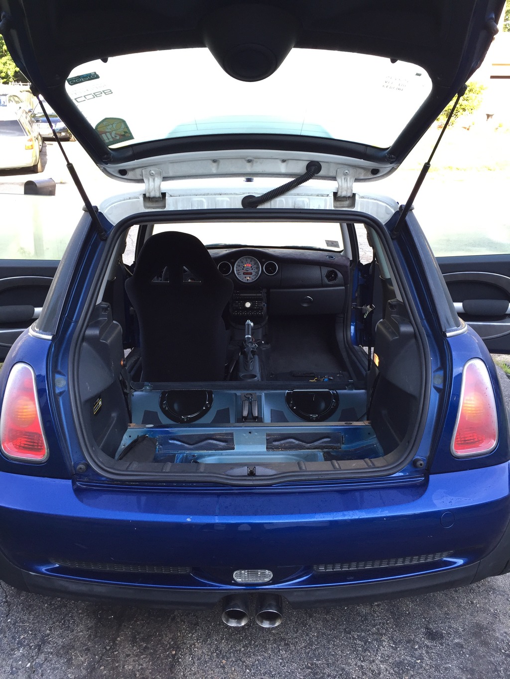

Little update...
I haven't had the time to build the seat bracket for the passenger side (girlfriend is pissed), so I've been driving it around like this..

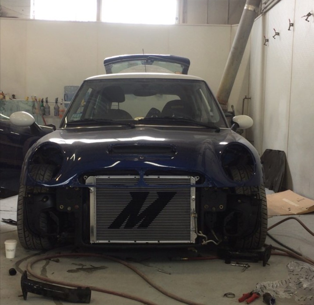

I dropped by the body shop earlier today to help the guys put the front end back together.
They were having some issues around the snake pit of radiator hoses and fitting the electric water pump back in lol.. So they called me over to assemble the cooling system and drop the new Mishimoto in..
Big thanks to Aaron at Outmotoring for getting the GP bumper and its bits from Germany to Boston is just 10 days! as well as for sourcing the Mishimoto as a replacement to the backordered CSF that I had originally ordered through the site.
I've bought stuff from just about every major sponsor on this forum, I'd say that Outmotoring has had by far the best customer source that I've experienced.
