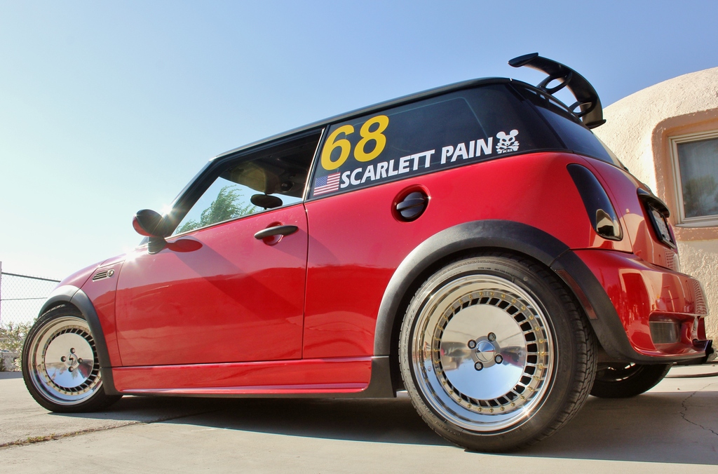

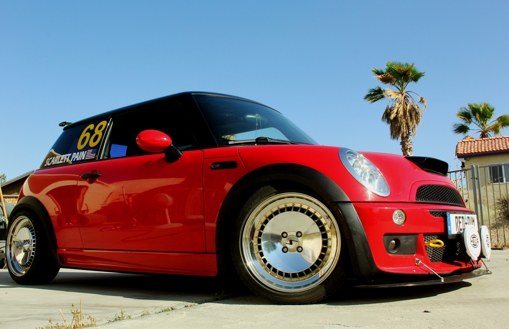

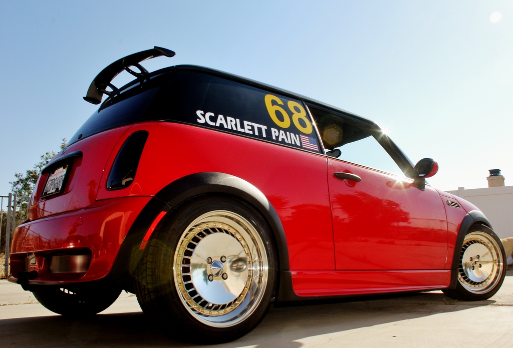

After more than two years sitting, we just finished up an RMW engine install. Redrum is back.

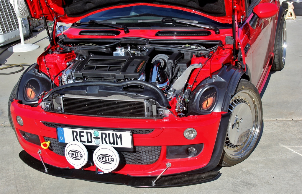

Engine by Revolution MINI Works Bored to 77.5mm at 8.5:1 Capable of 350+ whp
RMW Custom Pistons
RMW Custom Rods with 3/8" ARP2000 Rod Bolts
Mahle F1 Style Rod Bearings
RMW Custom Oil Pan Baffle
New main bearings, oil pump, chain, chain tensioner, chain guides, rear main seal, head gasket, ARP head studs, and all gaskets.
SFI FluidGel Vibration Damper Crank Pulley
RMW Big Valve head with:
Black Nitrided 1.8mm Oversized Intake Valves
2.3mm Oversized Inconal Exhaust Valves
Supertech Valvetrain with Titanium Retainers and Beehive Springs
ARP Head Studs
RMW Custom Camshaft
We already had the RMW head and cam and it was all refreshed

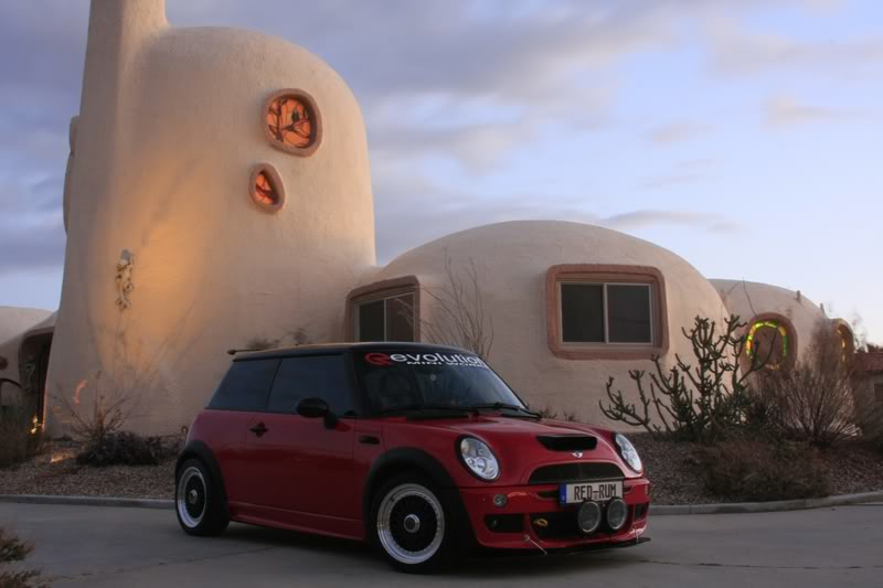

If I'm not mistaken, you are the one with the really cool home. Am I correct? If so, show the crowd a shot of your MINI and house--It's worth a look. If I'm smoking crack, ignore this post.
Old Jun 8, 2015 | 09:18 AM
batrugger's Avatar
batrugger
iTrader: (8)
Joined: Dec 2005
Posts: 1,081
From: Hesperia, Ca.
I don't know if your smoking crack or not lol, but here is an old photo from when it was in MC2:
