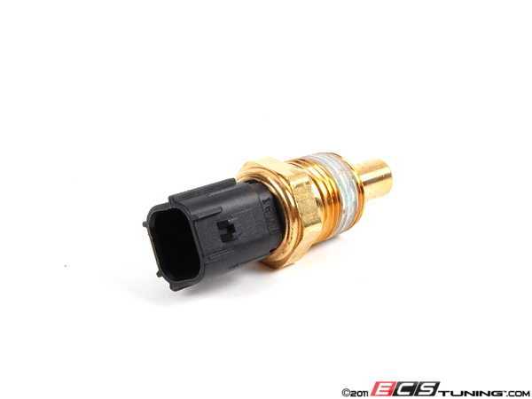

The fan kick on with the A/C on , think high speed and when you have been running the car hard or in high temps.
I would check those wires and plugs. Check that temp sensor in the head. Sounds like its bad or something. But if the coolant does not reach the sensor because of air, that might be an issue. Did you change the coolat or have a leak ?
13621486698
http://www.ecstuning.com/Search/SiteSearch/13621486698/
Location:
https://www.northamericanmotoring.co...mp-sensor.html

checked wires, plugs, fuses, relays. I did loose some coolant when I replaced the cooling fan but think I finally got the air to purge out of the system today. I am at a total loss on this one????
only thing left to do is replace the temp sensor, if that doesn't work I'll be hardwiring a 2 speed fan switch and mounting it on the dash.
