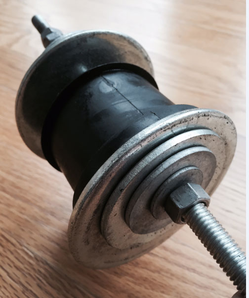

Blowntranny - funny - sounds like we more or less made the same press tool. Here is what mine looks like with Powerflex bushing in it:
I don't know how you got it. I must have tried a dozen times before giving up...I could not keep it on center. The rod I used is 12"...so I had plenty of ability to steer the rod. But right when it seemed like I had it...the thing would flip off to the side and go downhill from there.
I also used a vice grip to help hold the back of the rod in place. I put some lubrication on as well to try to help. But no go.
I can totally relate to wanting to empty rounds into the thing in frustration. I love it when people post helpful videos show ways to accomplish a job...but in this case I wish I never saw the videos because in this case I think it led me down a wrong path...at least one that I didn't have the skills to handle the hard parts they left out.
I can't believe you ultimately got it to go...well done!
Fastlane - that is a great idea putting a large socket in the bushing as a way to keep the rod straight and on center. I'll give it a shot tonight...one last try!

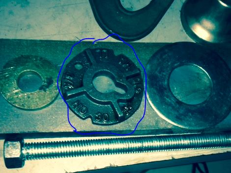

I believe ours are different. From looking at this, your largest washer most likely has a large hole. Combined with the other washers - this will make it slide.
my largest washer has a hole which is slightly larger than the 5/8's thread.
I will take a picture of it later tonight.
As Fastlane mentioned, once you get the bushings in - use a prybar to get the control arms lined up and pressed in, this was the only way I could line up the control arm with the inner ball joints.
Don't forget you will have to take out the axels to change the inner ball joints. I had to replace the passenger side due to a ripped boot. What a cluster that was. If you buy a new cv, they will sell you one with the wrong bracket, its off by 1/2 inch. I had to take mine to a friends place and have him press off my old bracket and then put it on the new axel. The video made this look easy, but this would not have happened with mine...it had to be presssed. Hopefully your boot is fine.

I appreciate that - and yes you are correct about the largest washer having a large hole. No doubt it lets things slide around - it was what the hardware store had. Fastlane's idea about putting a socket inside the bushing may indeed help compensate for this issue. The other difference is the rod I have is 3/8's instead of 5/8th's...that likely isn't making it any easier as well...most chance for movement. I'll give it another shot...thanks again guys for the pointers.

Here's a pic of what I used.
Attached Thumbnails Trying to remove control arm - pointers?-press.jpg   Trying to remove control arm - pointers?-press2.jpg
