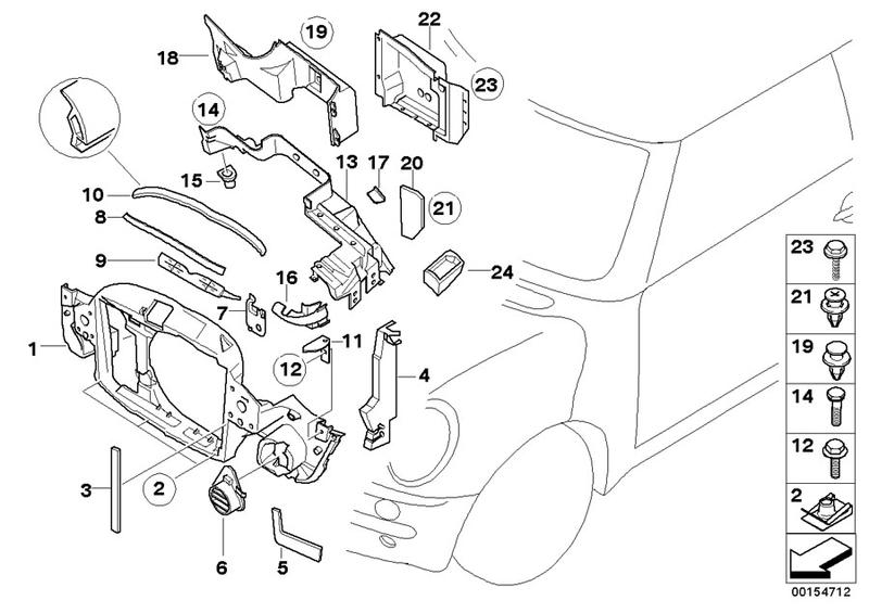

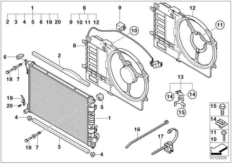

Here is a start...
See the Parts images for placement ...

The crescent moon shaped piece fits next to the starter to keep crud out of the bell housing of the transmission.
Part #10 here - http://www.realoem.com/bmw/showparts...16&hg=23&fg=15
The top piece in your picture I am a little less sure about - I think it holds the wiring harness in the same area (where the starter bolts to the back of the engine) - it has two closely spaced holes, I think one fits over a locating stud, the other is for one of the starter bolts.

Lower left is the wiring harness bracket that is held by the bell housing bolt under the thermostat housing.
Middle 2 is the brackets that go under the bumper bolts to support the front plastic rad support.
Lowr right is cover that goes under the starter around the pass axle where it goes into the trans. held in by 2 10mm bolts
Top middle is the bracket that holds the wiring harness going to the A/C compressor and Crank sensor. The bell housing bolt under the black supercharger inlet tube holds this.
