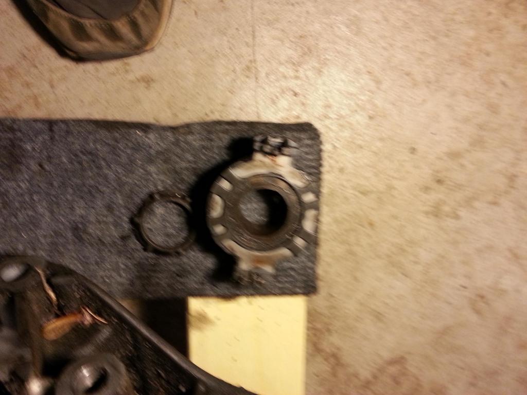

Hi all,
I just bought a 2002 mini "justa" cooper from a family member and was told that it likely has a bad transmission. Car had a new clutch installed recently (within a year or two) and ran fine until apparently there was great difficulty shifting the trans which then ended with some clanging sounds. At this point, the car would not move in any gear.

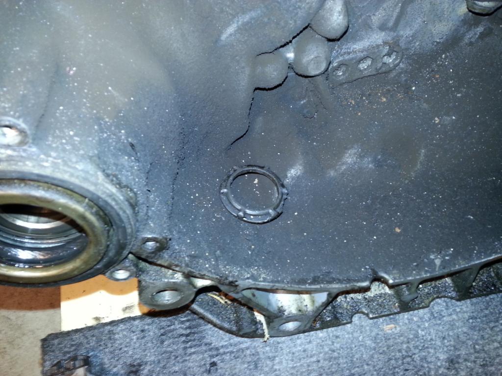

Expecting to rebuild the transmission, I removed it and found what I think is a piece of the throwout bearing but I'm not sure. It certainly shouldn't be in there... laying in the bottom of the bell housing.
I think what actually caused the symptoms was the throwout bearing jamming on the guide tube. It does NOT move smoothly on the tube anymore, even though the bearing looks OK. Can someone confirm what this piece is? Maybe it stabilizes the bearing so that it does not jam?

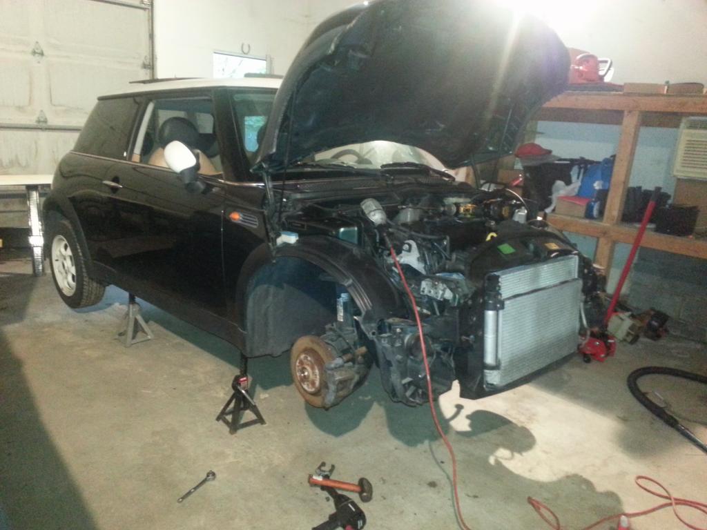

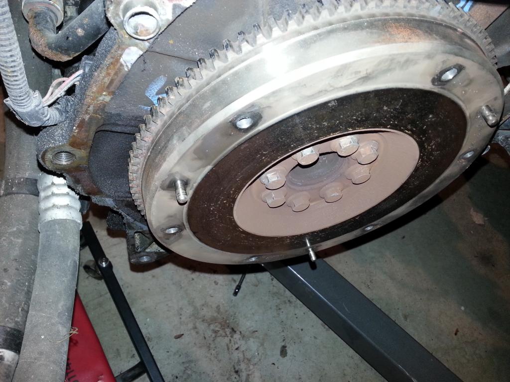

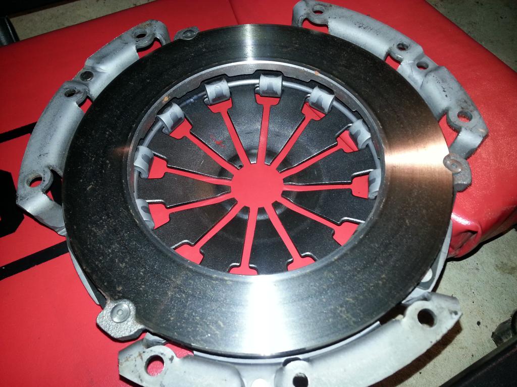

Here are some other pictures of the adventure:

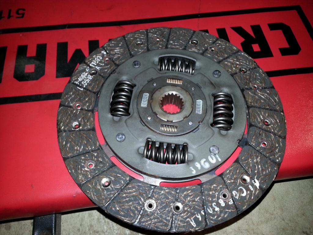

Note how the labeling is still on the clutch:

Yes that looks like the ring from the throw out bearing.
You should replace the guide tube while in there as that will keep it from sticking.

OK, thanks for the suggestions. I'm definitely planning on doing some suspension components while I'm in there. Also will need to do a water pump (its leaking), serp belt, crank position oil seal and maybe an oil pan seal.
It looks like the throwout bearing design has changed over the years? mine had the plastic ring on the back that seems to have just broken off... does anyone make a metal one that will work on an OEM clutch kit?

Looks like they replaced the clutch plate and Pressure Plate that was it, reused the Flywheel and original Throw-out bearing... and it was the Throw-out bearing that gave up the ghost and caused the failure.
For additional parts to replace since you have it apart... I would suggest bearing and seals.
