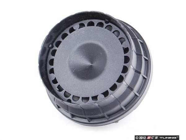

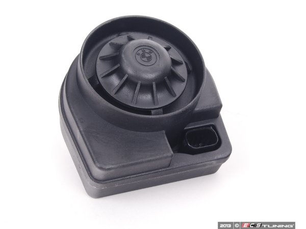

Hello,
So the siren went off in your hands after unplugsed? Some of the tilt sirens are shared with BMW and MINI and suffer this same problem.
There were two different sirens in the early years of the R50/ R53 Chassis.
I think they have back up battery in the Serine as the back states disspose Ni-MD. I bet its a bad Serine.
I know you are in the UK.
Which one does it look like ?
Tilt Sirene 65756914293
http://www.ecstuning.com/Search/SiteSearch/65756914293/ES2675593/
Or
Tilt Sirene 65756970943
http://www.ecstuning.com/Search/SiteSearch/65756970943/
Just match up for replacement.

Its the first one 65756914293. I thought of going on ebay and getting another second hand but I then thought that it will also be 11 years old :( i'll have a look and see what price a new one is over here. Thanks for your help
