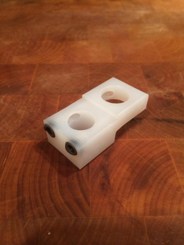

Fresh from the oven, guys!!!
Installed:
Condor Speed Shop will be listing this item on its site this weekend. Hurry & grab 1, initial batch is limited.
Remember to remove most of the PS fluid & air off the rack by turning your steering side to side prior to bolting up. Expect higher steering resistance than having a good pump, but better than leaving a bad 1 in.
Thanks for following.

Tony, my kit is still on its way. I just intend to keep it handy. Condor just finished the initial batch & has test fitted the kit on the donor rack. No relative comparison data out yet. There is nothing else we can mechanically tweak on our rack's steering resistance w/o the pump but letting whatever risidual fluid & air flow smoother from 1 chamber to another can really help lessen it. Let's await feedback from real world usage.

Remember to remove most of the fluid off the rack by turning side to side w/o the banjo bolts on prior to attaching the delete block.

The delete isn't hard to install in itself, remove both bolts, install the block with washers and you're done. Of course, if you like it deleted, you can remove the pump, reservoir and lines, which is the longer part of it.

You can have access to the two banjo bolts from the driver side, so you remove the wheel, put an oil pan under the rack, remove the bolts and install the delete. Then you have disconnect the battery, unbolt the fuse block and flip it over so you can remove the 100 amp fuse for the steering pump. No matter if you keep everything there at first or not, you want to kill the power to it, either from the fuse or the connector (just don't drive without covering both the plug and the connection on the pump if you go for this option).

Don't leave any!! Clear it all out by turning the steering wheel full left and right. Fluid will just make turning more difficult.

Use the original Banjo bolts---they allow air to move freely thru the plastic piece. You should have 5 washers according to the web site--instructions there also.
