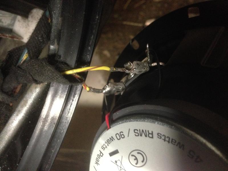

I installed a kenwood BT958HD
http://www.kenwood.com/usa/car/receiver/kdc-bt958hd/
All was working great but the passenger side stock door speaker blown.
Replaced them with Rockford Fosgate R165X3 Prime 6.5-Inch Full-Range 3-Way Coaxial Speaker
Amazon.com : Rockford Fosgate R165X3 Prime 6.5-Inch Full-Range 3-Way Coaxial Speaker - Set of 2 : Vehicle Speakers : Car Electronics Amazon.com : Rockford Fosgate R165X3 Prime 6.5-Inch Full-Range 3-Way Coaxial Speaker - Set of 2 : Vehicle Speakers : Car Electronics
install went smooth used
(yellow/Red) as positive
(Yellow/Brown) as negative.
But im getting little to absolutely no bass. I know these are not comp speakers and entry level but still should get something. Sound is nice and crisp.
I made my own spacers Do you all feel this could have anything to do with it?
Im also thinking about pulling them back out and switching the wiring just to see if that helps any at all.
right now the back stock still out power the fronts on bass.
thanks for any advice in advance...

It could be reverse polarity at the speaker and the lower tone is being cancled from the other speakers. Could be a filter in the head unit that is set too.
I checked this twice.
and everything is perfect of the wiring side.
Attached Thumbnails Speaker issues.-photo-1.jpg   Speaker issues.-photo-2.jpg   Speaker issues.-photo-3.jpg

Did you check the fade between the front and the back speakers…. The back speakers will give you all the bottom you want (Well… within reason) 6.5 coaxial speakers won't give you a ton of bass either way.. they're meant to run with bass speakers or a sub..
