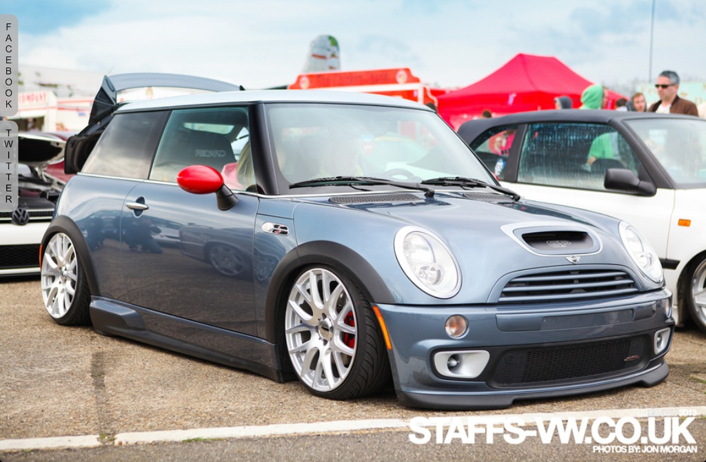

Looks too high compared to the 06 below.

Coils are in the plan, but not THAT low, haha!
