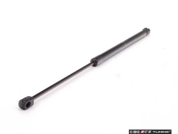

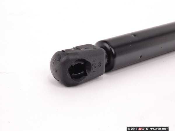

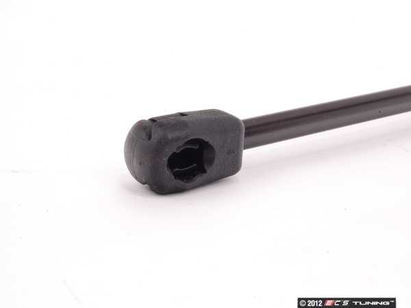

Its not that hard , you can pop off the Hood ( bonnet ) struts. One per side, change them out one per side at a time and I would both. A flat blade screw driver and a cloth ( so you don't scratch anything ). Get behind each head and lift them off. If the hood will not stay up at all I would use a stick to hold it in place.
Line up the new one and press / snap in the ends to the little pivot ball.
Make sure you put the new ones in the same orientation. Also you can lube the pivot points with some common grease if you want.
http://www.ecstuning.com/Search/SiteSearch/51237175020/
We have the hood and Hatch Kits at the bottom. Same thing for the rear.
