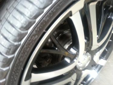

Some picks of the difference, its a bit exaggerated from the two pictures but you get the idea

Stupid question but have you measured the spacers to be certain they were not different like maybe machining error? Also have you removed and checked the rotors to ensure they are the same?

Looks like more than 5mm in that pic.
Yeah its just the angles of both pictures, I wanted the most drastic angles to best display the problem.... but trust me its about 5mm difference in person.. any ideas? The spacers are definitely 15mm, will take the wheels off tomorrow to check hubs/rotors for any differences.
