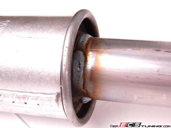

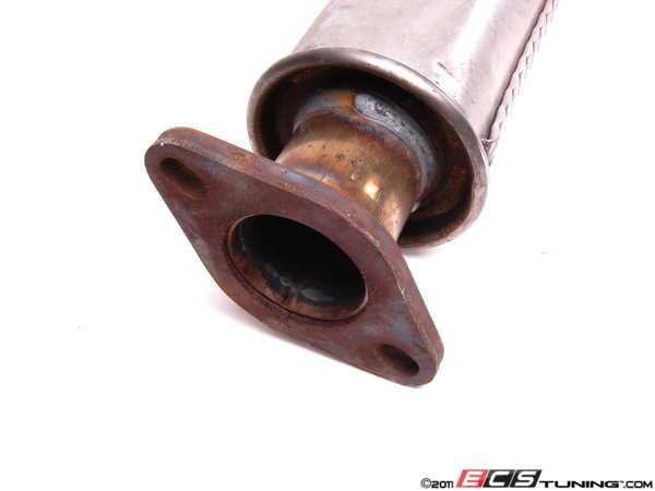

Looks like you have a R50 MINI Cooper ( non S ) based on the selection. I have re-posted a better picture. For the US cars #4 cannot be replaced its part of number 1 which is the whole exhaust.
Muffler - Rear Part #18307537083 #1 in the above diagram.
http://www.ecstuning.com/Search/SiteSearch/18307537083/
The front section is resonator and is part of the whole rear exhaust system. It sounds like the out to it is rusted and was temporally fixed and then came apart again. That could be causing the loud noise, as there is might be exhaust coming out of it now. This is dependent on how bad it is. below is the unit welded to the pipe.

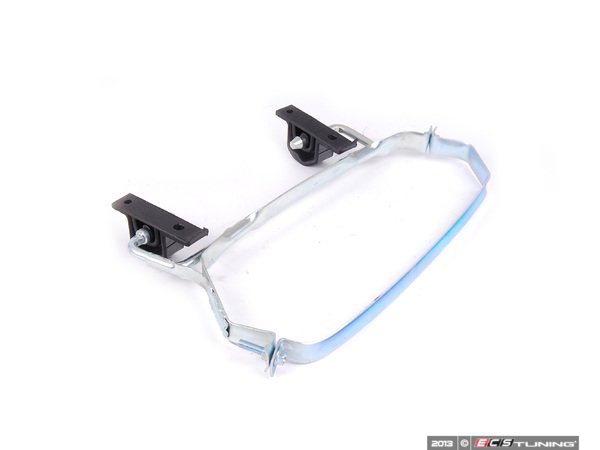

Also check the rear muffler strap as they can rust and cause the exhaust to slide around in the back and make noise. Also the protective shield that is welded to the rear muffler can rust apart. These can make noise.
The upper clamp can rust apart which is #13 in the diagram. We carry a clmap kit that has the upper and lower plus the rubber mounts:
Clamp Bracket
http://www.ecstuning.com/Search/SiteSearch/18207520245/
